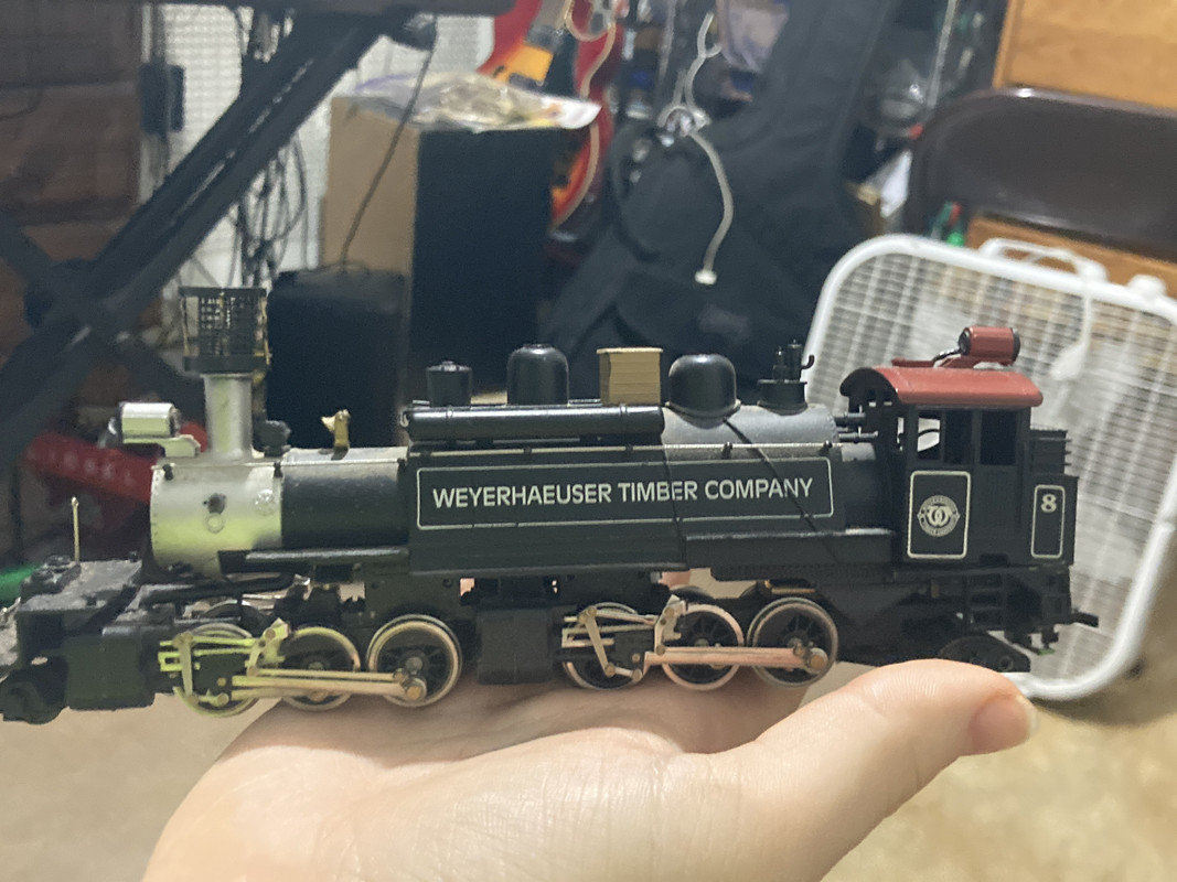

So among a few of my mantua engines my favorite is my 2-6-6-2 mallet #8 but I have no clue how old it actually is and if it has or can be converted to dcc. This is one of several ho engines I bought at a garage sale for two dollars a engine and it runs great with directional lighting.

my mantua mallet doesn’t have that circuit board in the cab. It has a 5 pole motor there.
Mantua switched from open-frame to Sagami can motors in the late eighties, so your engine would be from like 1987 or a bit earlier.
Mantua made a retrofit ‘kit’ to replace the old open frame motors with the Sagami can motor. Since you have to remove the motor to insulate it from the frame (for the DCC conversion) anyway, you might see if you can track one of those kits down on Ebay etc.
You’ll need to do a “hardwire” installation, meaning you’ll need to get a decoder harness and solder the wire connections to the track, lights, and motor.
And if you’re wise, you’ll read the threads here about converting these open-frame motors to use high-strength NIB magnets. Do not cut or grind these to get them to fit – use steel or soft iron. Decoders don’t like high motor amp draw, which is typical of older motors as they age.
Stone and clean your commutator and clean out the slots, and be sure your brushes are making solid contact. You don’t want intermittent contact at any sort of high current…

This is the mantua mallet! The mallet!
This is what I meant by the 5 pole motor.
The 5 pole motor!
