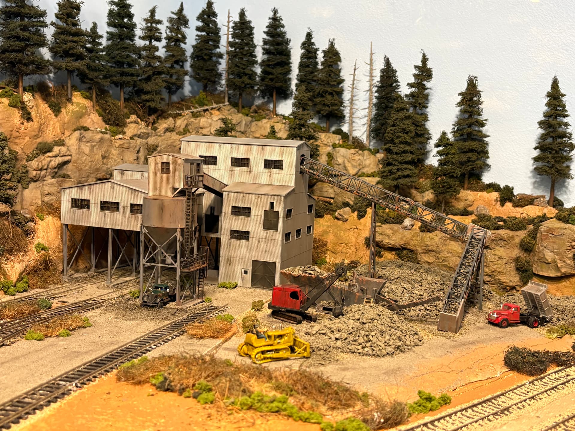

Scene also plays a role. I have several areas on the layout of forest-covered hillside. Here, only the first row or two of trees are even fully modeled, the rest are essentially blobs of flock-covered base material stuck directly to the ground. You’re dealing in almost complete illusion in that case… Or spending a fortune modeling a forest entirely in full-blown trees that won’t be much seen anyhow.
