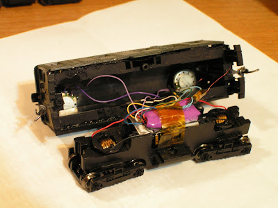

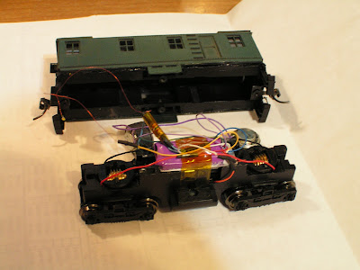

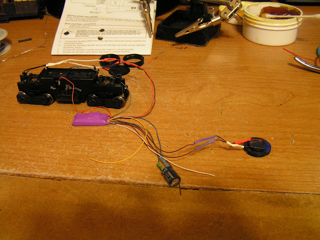

Check LokSound and SoundTraxx for what “might” be an appropriate sound. No idea myself.
I put a LokSound Micro v3.5 in two different 44 ton single motor locos and a LokSound Micro v3.5 in a single motor 70 ton. All three have a 16mm x 35mm oval speaker with home made baffle.
I ripped out all the other stuff. I had to cut a little out of the 44 ton frame to clear the speaker. I put the details somewhere in the DCC forum.
Pushing the current limit for the Micro but never had any temperature issues but I run them a little under the prototypical speeds for the locos.
I guess a Tsunami Micro would work.
I used a Micro Tsunami in the 44 tonner for my MDC Climax and Boxcab, rip out the factory board and toss it, (you will need the extra room) and hardwire the decoder. in the Boxcab I used two speakers.
http://gearedsteam.blogspot.com/2012/02/tsunami-sound-decoder-install-mdc.html Climax
http://gearedsteam.blogspot.com/2012/01/installing-sound-into-boxcab.html Boxcab
Have fun!!
