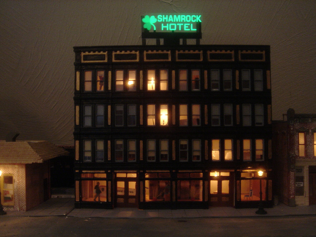

The Shamrock Hotel has one of these signs:
This is HO scale. I put the connector into the roof and ran the ribbon cable down the back of the building, through a hole in the base and through 2 inches of foam. I just let it hang there below the layout. The ribbon cable is long enough, and the circuit board weighs next to nothing.
I replaced the battery pack with a connection to a 12-volt bus with a resistor chosen to provide the desired 4.5 volts. I don’t have to change batteries, and the sign comes on with the rest of the layout when I flip the switch on the outlet strip.

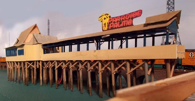

I want a custom pictorial sign for my pleasure pier nightclub. I recently put a try-out mockup test roof and a Photoshop printout of my dream sign design on the unfinished model.
Maybe i ought to try one of the stock Miller signs first…
ON my Shamrock Hotel, the battery box and module sit on an upper floor. The roof removes easily to turn it on and off. I will eventually get a Miller power supply and run it and other signs off that.

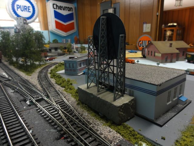

I have also done a Reddy Killowatt sign for Boothaby Railway Village. It is a bullboard, and I scatch built a “concrete” base for it. The sign has not been installed yet, as we are still working on scenery in the area. This is a post construction photo of the sign and power plant
Motley, thanks for asking to see the sign.
Mr. B… I ran out of velcro after securing the battery box and left the on-off module hanging as you did and actually like that better than attaching it.
Cement base
Sign in daylight.

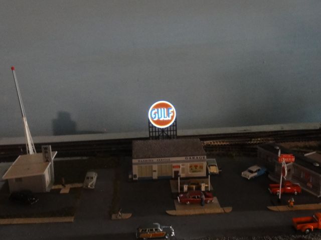

Sign at night
