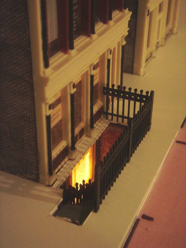

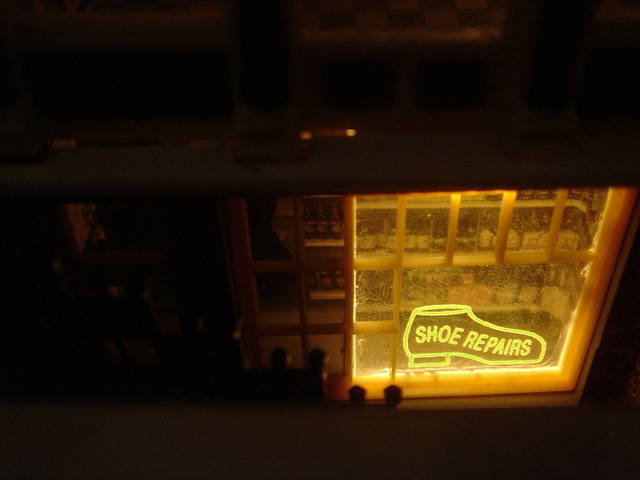

I have a few of them that have been running on their power supplies for years with no problems. You might want to look at Miniatronics, too, for other options in illuminated signs. I put a shoe repair shop in the basement of this City Classics building:
It’s hard to photograph, but the sign just fills the window and also provides illumination for the shop.
