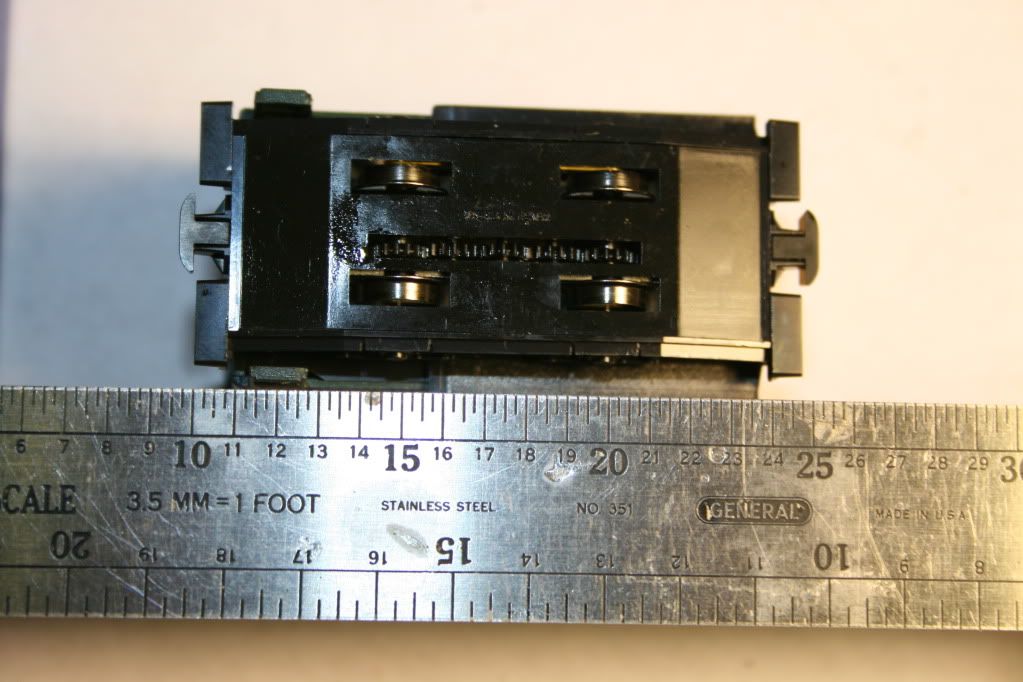

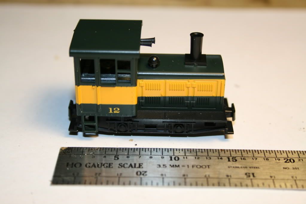

Sounds like positive improvements. Can you tell if there’s still room to spread each wheel out about a millimeter wider on each side, i.e. from 9mm to 10.5mm/HOn3? I’m pretty sure that’s all that was involved previously.
Then there’s the cab. Room inside for a decoder or does the new motor take up space?

I don’t know about that “spreading”. The gauge on these is actually a little less than 30" in HO - likely to accomodate tight curves. I don’t have a need to disassemble mine and did not do so. It appears that some milling of the frame outside of the wheels would be needed, and looking in there it appears that there is some sort of copper wiper outside of the wheels that would need to be modified.
And I’m not one that is familiar with decoders, as I operate DC and have many older HO locomotives that would need conversion. There is already a small circuit board of some type under the cab roof - affiliated with the headlight. In HO-scale feet, the space within the cab measures 4.5’ long by 6.2’ wide. Given that there are reliable decoders for N, perhaps there is something that would fit. Again, I did not open up the locomotive to determine if there is any other space between the motor and the underside of the shell; glancing in from the cab, it would not appear to be the case.

Yes, thanks, very helpful. Looks like things are considerably improved, at least versus my memory of the originals. Everything under the hood, so to speak, I’d say. There was no lighting in the original. The drive looks much better from what I can see.
I suspect a conversion is workable, though. You noted how the bottom of the frame is right next to the outside of the drivers. Is it plastic or metal? I can deal with either, but curious. I suspect that the axles go through, as I can see two shiny spots on the underneath shot, but don’t see them in the side shot? If so, then it will likely be a matter of cutting as needed underneath for clearance outside of the wheels, then sliding the wheels out.
The copper strips are likely the electrical wipers. These can usually be bent to adjust to the wider gauge.
Then there’s the couplers. That’s going to require a ‘porch’ on each end to get enough clearance for them, but I did that recently when mounting dual gauge couplers on a Bachmann 44-tonner, so no big deal. It looks interesting. I wonder who is going to be first to chop one of these into HOn3? It wouldn’t surprise me if someone already has. And I think they should consider offering HOn3 from the factory, Looks like there’s enough room and that’s a booming market.

The bottom cover plate appears to be plastic - I scratched it a bit with an xacto. And yes, the axles DO extend out past the “outboard” side of the drive wheels - I just double checked that.
