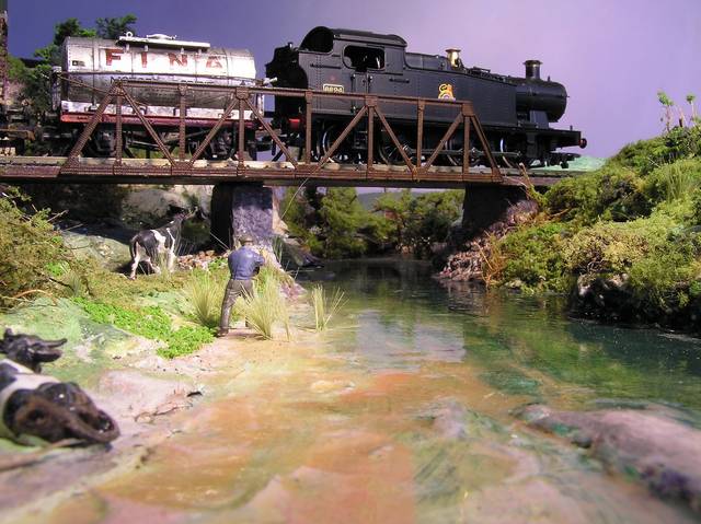

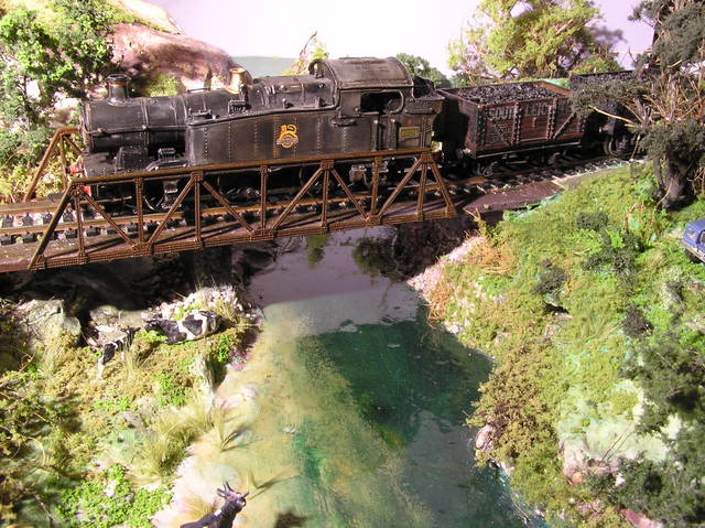

Hi Michael No I haven’t tried it, and I really don’t think I would. But maybe if you could have a trial run first - something you can ditch if it fails. You can get a very convincing reflective surface using epoxy resin, or even varnish [which I used for my river] painted over a dark greenish base, paler around the edges where it gets shallower. My river is only reflective when viewed from ‘ground’ level. I think it would be unnatural if reflections were still prominent when viewed from above - from that angle you’d be much more likely to see the bottom of the pond, or at least the colour of the water, rather than reflections.
Links to a couple of views of my river, one from above, one from ground level.

Mike, wow! That looks great! What type of varnish did you use?

Thanks, Tom. I used High Gloss Polyurethane clear varnish - Estapol was the brand.
Mike
