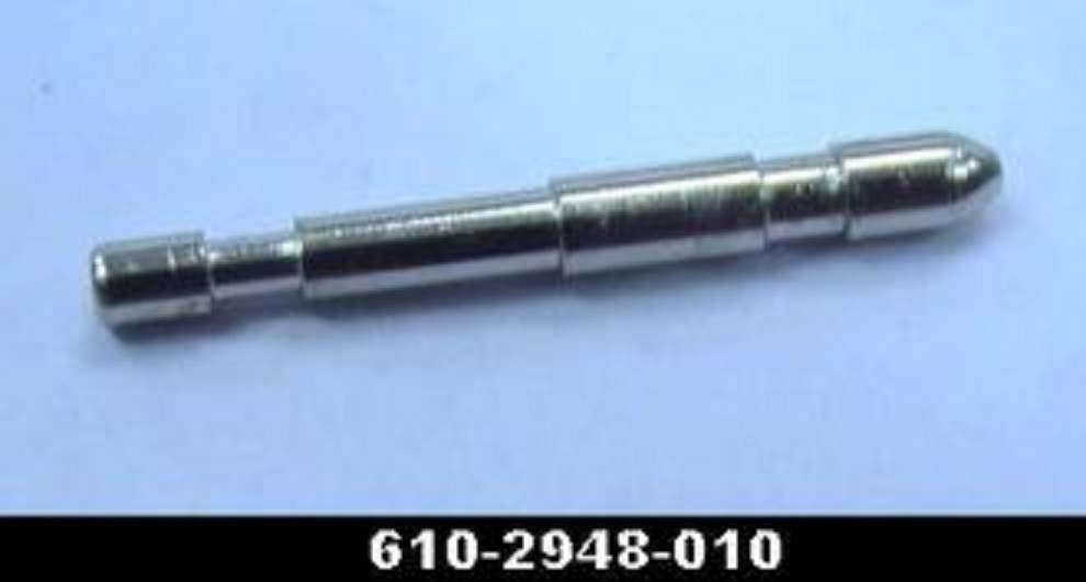

where do you find the adapter pins to go from 0 gauge to 027? I want to use for switches. How much $$?
where do you find the adapter pins to go from 0 gauge to 027? I want to use for switches. How much $$? where do you find the adapter pins to go from 0 gauge to 027? I want to use for switches. How much $$?
Although this part is offered, it will be quite a bump at the transition point due to a design flaw.
It really should be offset, like the GarGraves adapter pins.
You can make your own by starting with three “O” pins, and grind one end(to the half way point) of each 3/4 of the way around to match the diameter of the O-27 track pins/openings.
If you instead grind them to the center like the above Lionel pins, there will be a significant “bump” at the transition.
For an example of this “offset” method, look closely at the GarGraves “O” & O-27 adapter pins:
And actually, forcing the O pins into O-27 at the transitions works quite well, and the bump is reduced to the slight difference in sheet metal gauge used to form the rails.
All of this assumes that you realize you will need to shim your O-27 track ties up slightly to match the track height of “O”.
