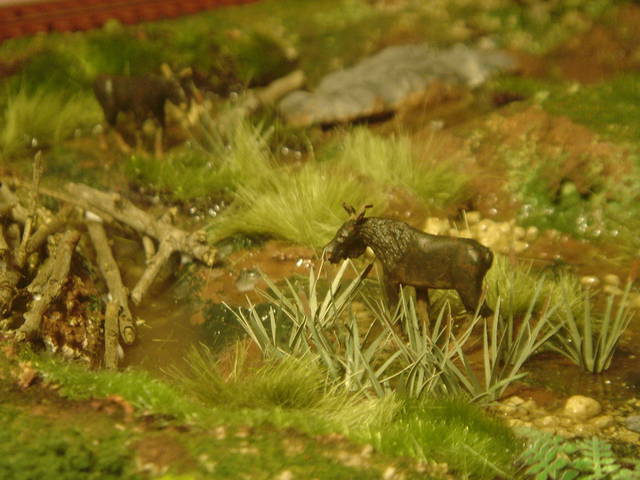

My own swamp isn’t quite done, but it’s been my major project for the last couple of months.
I used Envirotex for the water, coloring the different layers from dark to light as I poured. I used a variety of “plant life,” expermenting with Walthers “botanicals,” particularly the cattails.
I got the moose from Musket Minatures, as well as the tree stumps and beavers.
For the final layer of Envirotex, I only used a bit of tinting, but I swirled some light green acrylic paint into the final pour after it was in place with a toothpick. It dispersed a bit, but concentrated the paint enough to give a murky, swampy look to the water.
