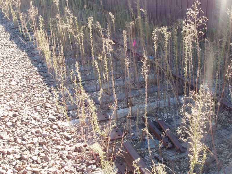

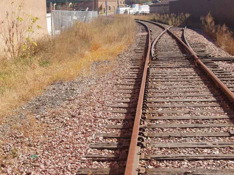

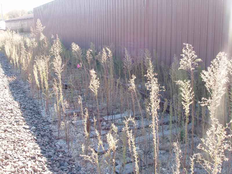

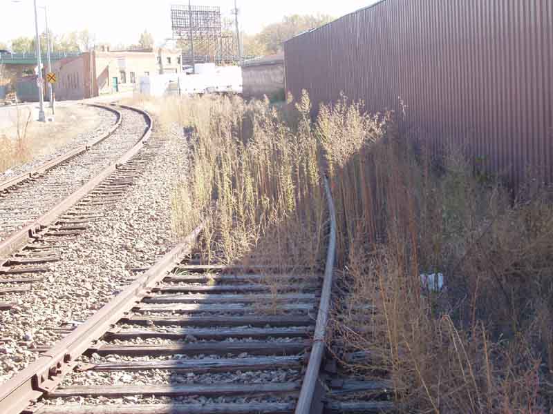

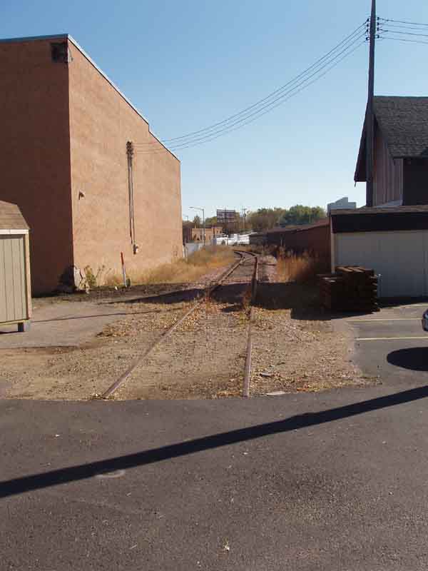

Here are some pictures I took of an abandoned siding in Sioux Falls, SD, about a year ago.
If you would like the full size version of these for reference, contact me via e-mail,
