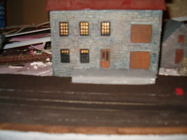

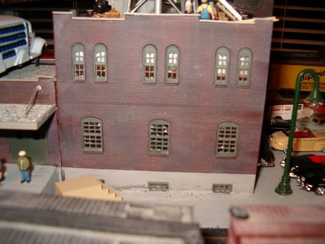

Real masons sometimes use a powdered additive to colour the mortar, too. If you’ve got a spare piece of brick material, try painting it several different shades of “brick” colour, then try several different shades of “mortar” to see which ones go together best. In earlier times, bricks were usually made not too far from where they were going to be used, so different regions often had a brick colour peculiar to that region. In the city that I grew up in, the predominant brick colour was quite orange, while 50 miles away, most brick was a buff colour. I used Floquil reefer orange to paint this structure, then applied pre-mixed drywall mud to all wall surfaces, using a rag. When it dried, a clean, dry rag was used to wipe away the excess. Then, the entire structure was given a generous thinned wash of dirty grey PollyScale paint. I applied this at the top of the walls and let it run down, siphoning off the excess with a paper towel. Don’t brush the walls any more than absolutely necessary, or you’ll remove the mortar.
Same orange base colour on this one, but no “mortar”. Instead, it got several very thin washes of a dirty brown, again PollyScale.

Here’s one of my first attempt using white paint rubbed on and then by used a sponge (both round and triangle types are found in the make-up aisle of Wally World) of red color over the top for brick color. Note more red and white show up in the camera shot then looking at it in person. Then I used a light wash of black color. I keep it because it was my first attempt.
And a later example. This was using gray paint as the motar.
And another example.
