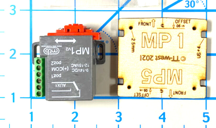

This is the MP10…just as an example. They make a bunch of different models, MP1, MP4, MP5, MP8, MP10, DR16 etc etc etc
as you can see they are extremely small by slow switching standards, only half an inch tall

Just spoke to Seth from MTB and he said that most people are using the default 6mm throw for N and HO with no problems (thats a lot of “spring” in the connection). Just awaiting a response to the ability to offset them to just outside the ties of the turnout and connect to the end of the throw bar. Will advise.
