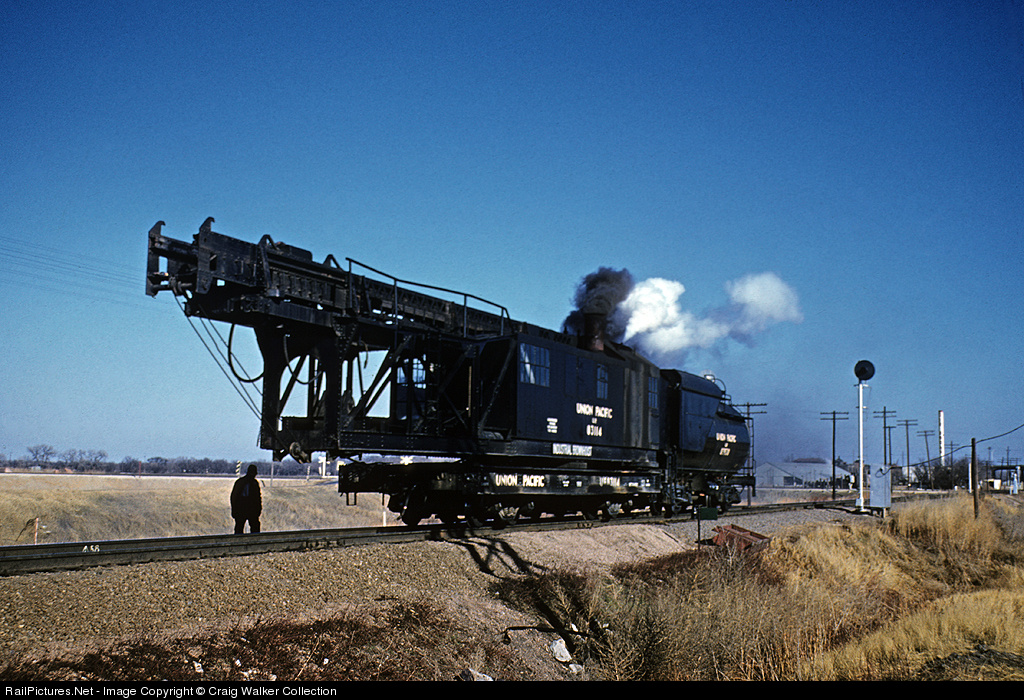

Not all steam wreck cranes were dieselized by the 60’s. I have pictures of a B&O steam crane working a derailment in the early 1970’s.
Mark Vinski
True, many were but not all.
I was at the “Ravenna Wreck” and a steam powered wrecker was still in use as of 1962:
Cheers, Ed
