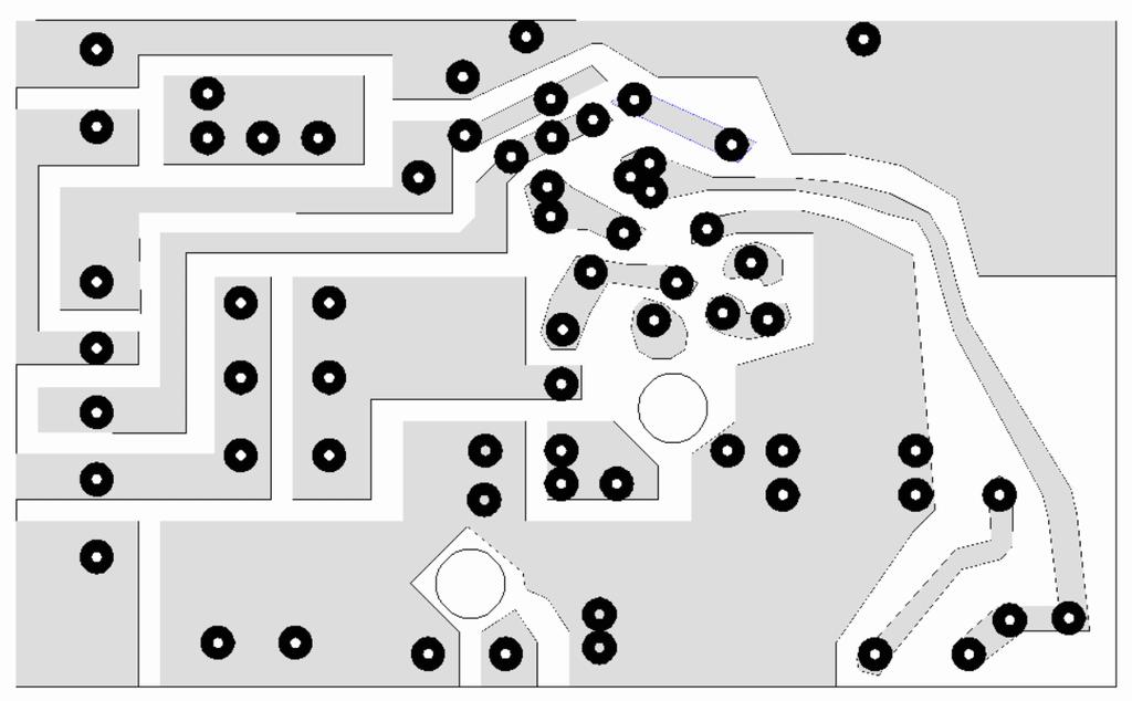

I was going to make a schematic of the MRC 2500 circuit board but stopped when you got yours working. I think it would be a mistake to take a working power pack apart simply to make a drawing.
Here is the drawing I came up with, I used the picture as a go by.
Mel
My Model Railroad
Bakersfield, California</
thanks for posting the diagram.
That along with the picture in the other thread may be enough to create a schematic
