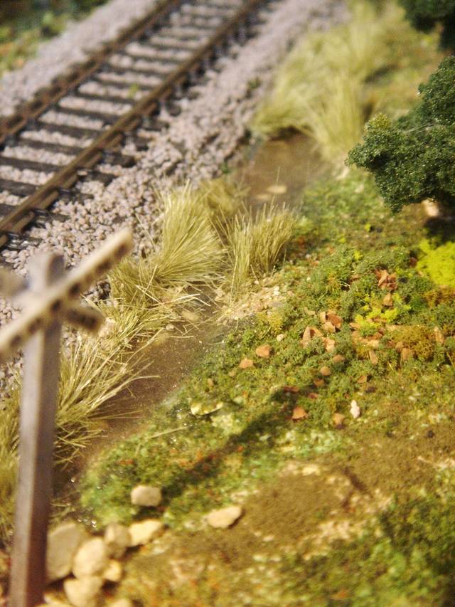

Hello here are a couple pics this one is after the first pour

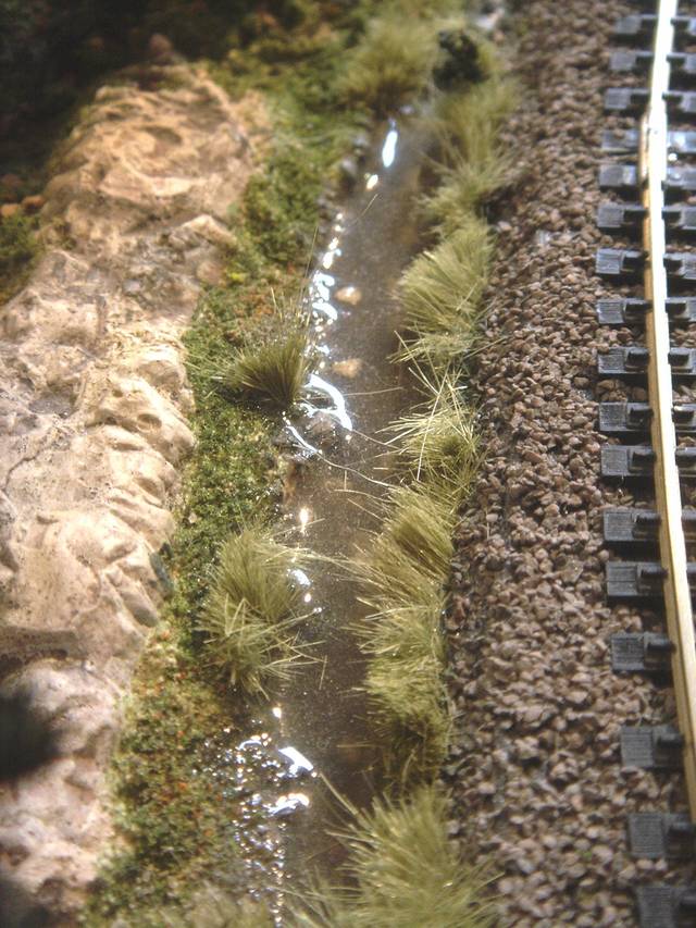

this was 24 hours later you can see it all soak in. It was dry and hard so I added some more and put in some grass.
I will give this time to dry and see how it looks. Have a nice day Frank

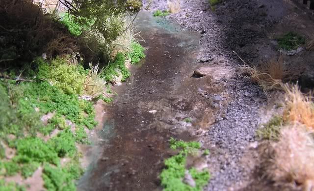

I done this ditch with polyurethane.

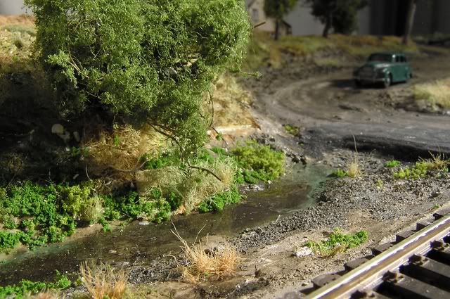

These are both done with Envirotex. I tinted the mixture with “muddy” colors, olive green and brown. I added talus to the bottom of the ditch before pouring the Envirotex. The field grass was applied later. Using scenic materials after the pour has set helps hid the “creep” up the sides of the ditch that happens with many of these “water” products.
