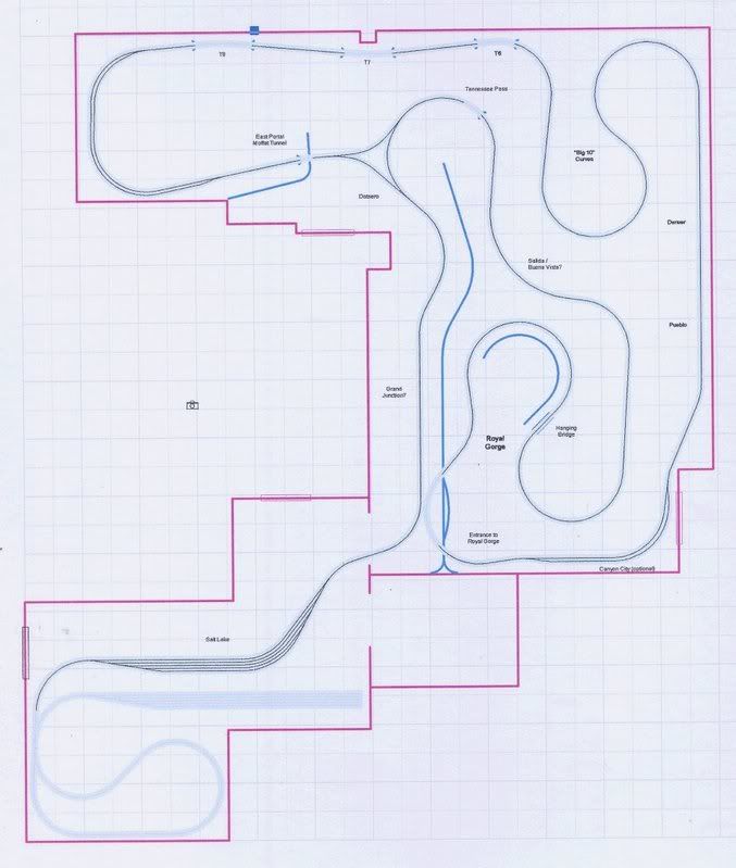

Here are my current track plan but it needs a lot of work because there are things I want to incorporate:
The first thing I want to do is to make space for Rio Grande’s Salt Lake City depot, Grant Tower and the wye so I can turn my Rio Grande Zephyr in the same way as the prototype. Here are som pictures of the Grant Tower area. Please give me some ideas how to do it. And feel free to change the trackplan in any way.

I’m confused. I thought the pictures you were posting were of the flat part of the Royal Gorge right before the hanging bridge. But this plan shows the Hanging Bridge in a big S-curve. Where on this layout plan is the picture being shown?
Don’t be confused my friend. The plan shows the hanging bridge in a S-curve, but I will move the hanging bridge to another location on the plan. The plan needs some updates.
