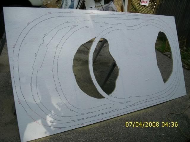

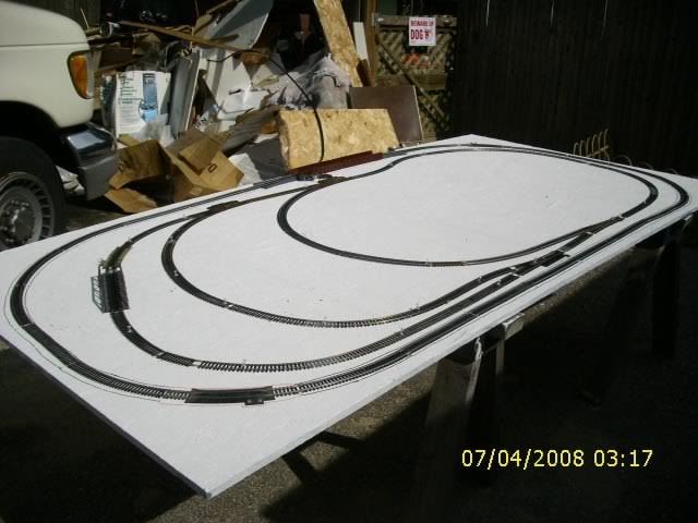

This is the track plan, I will have to make one adjustment after talking to my Buddy Cuda ken, the “S” curve I’m told can not be used because it will derail my trains, other than that small change I like the two individual tracks.

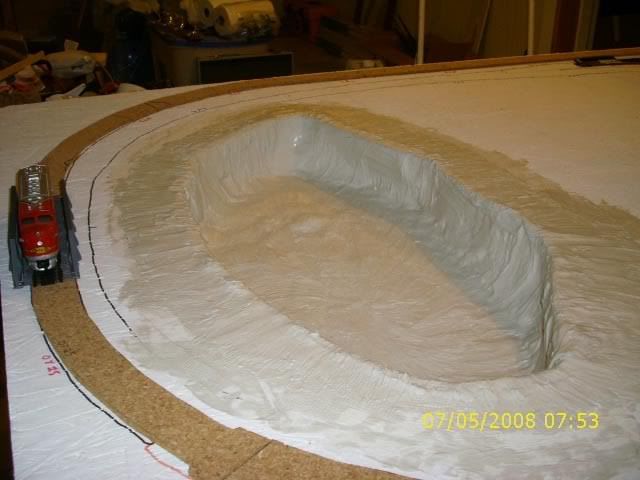

In this pic the hole on the left with the track bridge is the pond, the hole on the right is my small quarry.
Here is my quarry that shows its scale and depth by the comparrison of the HO scale F7.

It looks good, but you might want to think about a siding or two and maybe connecting your outer loop with the inner track. (just a thought…[:)])

Well I didn’t want to connect the two tracks so I can run one train in one direction and the inside set in another, besides this will allow the Grandsons to operate their own when visiting.

You can still join the two loops and run two separate trains at the same time. Just use insulated rail joiners where the two turnouts meet.
http://www.atlasrr.com/Images/Track/Trackphotos/55.gif
These will keep the loops separated into two circuits or “blocks”. These are also used to isolate sidings on a DC layout so you can turn off a train sitting on a siding while you run another train on the main. (in case you didn’t know about these.[swg])
I agree with loathar with connecting the outside to the inside loop, Jess. Some insulated rail joiners, and an Atlas Selector(?)(Controller?)(the one with the green buttons) switch will get you going running multiple trains on each main.

Did you run a train on the layout in the first picture before you went the next step? Over all I like the lay out and 2 lines is a big plus. Next time we talk, well you will be done at the rate you are going, but I will help you with blocking. That way besides having the A and B line running at the same time, you will be able to park trains on the passing / spurs loops you have.

OK, I’m starting to get the picture, that would be cool, I will keep an area open so that I can add a connecting track between the two, I’ll look into what I’ll need for that and the track isolators.
Now I imagine that if I add the track isolators to the loops as well I’ll be able to pull a train onto one of the loops and then disconect the track power using a controller and the isolators.
Now, if I’m on track 1 (the outside loop) and want to switch it too track 2 I’m guessing that the throttles (speed coming from the transformers) would have to be set at the same speed as to not derail by rolling onto a track that is set too slow…does this makes sense?
I thank you all for helping me see that I can have two tracks but be able to link them, I was not aware that this could be done but I should have known better.

Jess-It looks like your using Atlas code 100 track. (right?) Don’t use their “snap” switches to connect the loops. Use at least #4’s. Preferably #6’s.

Now are these #4 or #6 also from Atlas?

RH:
After you connect the two loops like people mentioned (use two crossovers, one made of 2 RH and the other of 2 LH, so you can get from one to the other and back without reversing), I’d remove the innermost or perhaps the innermost 2 cutoff tracks, then put in a 2 track yard coming off one side of the inner loop, and a branch to a mine or something in the middle of the layout, off the other side. This will give your trains something to do. Start at the yard, make up a train, take it to the mine, pick up the loads, return to the yard, while keeping out of the way of mainline traffic.
