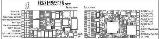

I am trying to get a better understanding of the Loksound 58420 sound decoder but there conflicting images on line. Which image is correct?
Image available at several on line stores:
Image from Loksound 5 instruction manual, Nov 2022
They both are. The schematic image is both sides of the decoder laid out side-by-side.
Good Luck, Ed
Ok, now I see it. Confusing to show the back side at the on-line stores. JMO.

I never noticed, but apparently the Loksound 5 decoder with the 8-pin harness is just their regular 21-pin decoder with wires soldered on to make it useable with the 8-pin harness. You can see the 21 holes in the diagram and in the photo.
