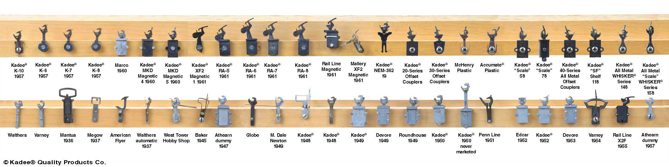

If it’s from the fifties, the couplers would have to be ‘after market’ because I believe the current style of Kadee couplers didn’t come out until the 1960s. Back in the fifties car kits might come with some type of dummy coupler (or X2F horn-hooks in the sixties or later), but more likely it would be “trucks and couplers not included”. Cars coming with Kadees or Kadee-compatible couplers didn’t really become normal until fairly recently.
An interesting side question - what kind of couplers do the cars in the picture in Ed’s link have? They look almost like European style couplers. Maybe Mantua ‘hook and loop’?
Mantua coupler
