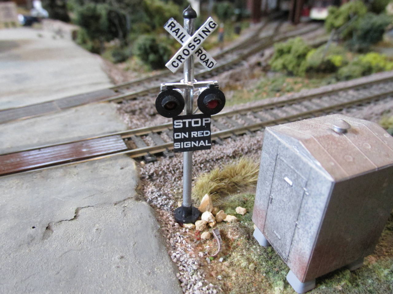

These are HO scale, but they’re an example. This is the Oregon Rail Supply kit:
The kit contains a pair of them. It’s a sprue of black plastic parts, LEDs and decals. The vertical shaft is brass. You’ll need some magnet wire (not included.) It looks like they only come in HO.

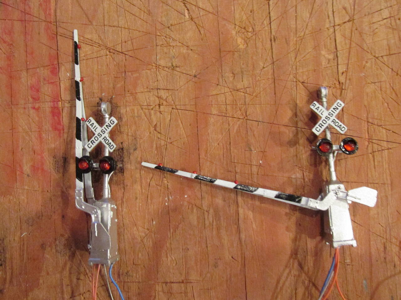

These are my HO-scale NJ International gates:
They come fully assembled. The wire that raises and lowers the gate is too short for my 2-inch pink foam, and I think it’s stainless steel so it’s difficult to solder on an extension. On both of mine, the wire broke off inside. I swapped some e-mails with NJ International, and they agreed that the linkage is weak and easily broken. We agreed that the best course of action would be to drill a small hole in the counterweight and drive it from there. This will give me a more robust mechanism, and the longer lever arm should provide a more realistic motion.
I’m going to drive the gates with a Tortoise and Circuitron’s remote signal linkages, 800-8100 and 800-8101. One Tortoise will drive both gates.
The NJ International flashers are wired with a common anode. The Oregon Rail Supply ones can be wired common anode or common cathode.
I installed the HO NJ crossing gates as well. Some advice on the install: center the Tortoise as best as you can between the 2 gates. When installing the linkages, what I did was hold the linkage in place by hand, mark the holes for the screws that hold it in place,remove the linkage, drill the holes, put a bead of Goo or contact cement on the linkage to hold it in place while you put the screws in.On the Tortoise mechanism, you will have the 2 wires and tubing coming from the gates. Get one working properly and use contact cement to hold the tubing in place on the mechanism. Then get the other gate working properly and glue it in place. I cut the wire longer then I needed as a safety issue. You can always shorten it once things are working. Joe
