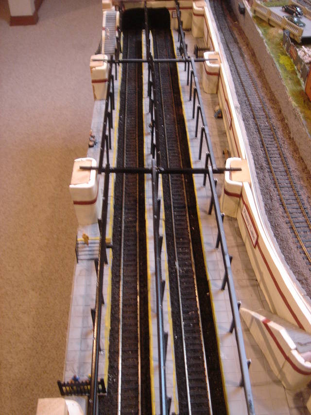

These things can take extreme abuse, too. The tile pieces used to surround the 1x2 wood supports which hold up the roof of this subway station were made using the same “bend the casting around a shape” technique. Each support casting is a single piece, bent not, once, but twice around a piece of 1x2 (with curved edges) to get it into this shape.
(click on the picture for a better view.)
This picture is basically taken at the same angle from the layout, but the roof piece for the subway was removed. The same ramp retaining wall is visible here and in the picture with the trolley in the earlier post.
