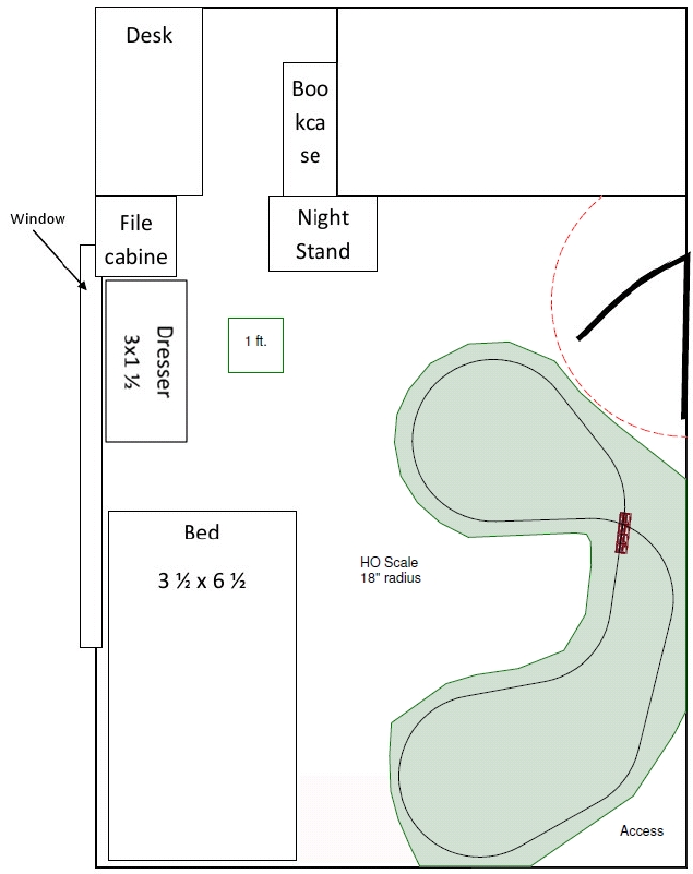

Click on post count under poster’s name to see his old posts. OP is a young person, with a room better suited for a water wings format than a 4x8 - here is the suggestion by Byron Henderson in an earlier thread for fitting a layout into his room:
For some unknown reason the OP has decided that this “just won’t work”, and gone back to a 4x8 in the lower right hand corner, planning to pull the layout out into the center of the room so he can squeeze behind it at times.
Ceiling height at lower end of room is low - so low that there is no room for a layout above a dresser if the dresser is located along the lower wall.

thanks for the information. I even did draw some weeks ago a N-scale version for the space Byron Henderson had found.
Smile
Paul
Paul, as much as I like your plan for the space Byron Henderson had found, I can’t put the dresser in front of the window or remove it from the room. I also already have a table that I can use.

Since you’re working in N scale, why are you working with a 4x8? Not only is it a space consuming size, especially in a bedroom, but it’s going to be nearly impossible to reach the area in the corner to work on scenery, clear derailments, etc.
You should seriously consider using a hollow core door slab, which measures 6’8 long x 36". (other narrower sizes are also available)
Hollow core doors are lightweight, easy to handle, and can be set on a base requiring no benchwork. There’s a great resource right here on the forum.
Since the layout can be self contained on the door panel, you can easily slide it under the bed if you need some space, or, you can get some narrower panels to set up over the dresser to make a staging yard or industrial area.
Get your head out of that 4x8 box. N scale offers you more flexibility than that!
