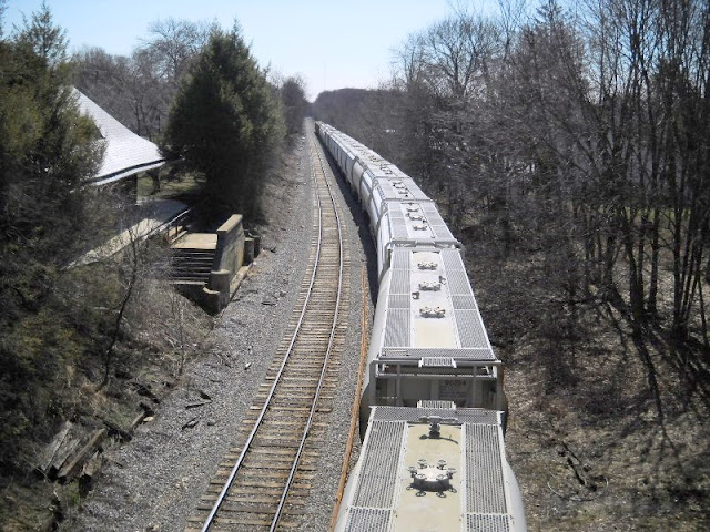

As far as tree height goes, consider that most deciduous hardwood trees grow to a typical height of 60’ to 100’ tall. This means that your trees should be at least as tall as a 50’ N scale boxcar is long. Most commercial trees that are marketed as N Scale are way too short. In reality, trees really do tower over the trains!
Of course, there’s a fine line between realistic tree height and cluttering up the layout, so I usually stick to the 50’ boxcar rule, and that seems to work out pretty well…
