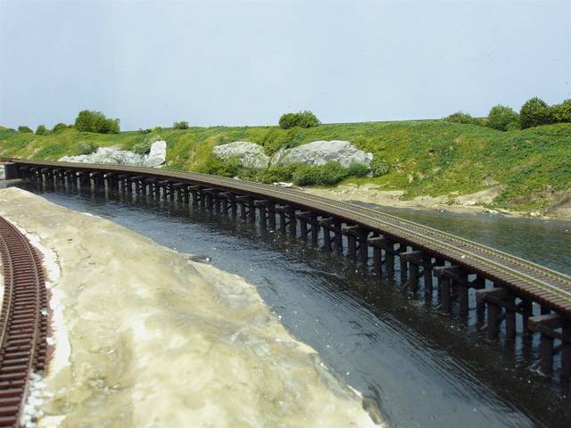

I used basswood dowels for my piles and 1/8" strips for my caps and stingers. The braces were actually made from flat toothpicks:
Depending on the size of your trestle and the level of detail you are after, there can be some room for fudging. I think my stringers are a but thick, but once the track went on, it’s hard to tell.

I used Evergreen styrene for the bents,1/16 round for the piles and assorted strips for the bracing and Northeastern strip wood for the stringers and ties. I painted it black so you cant tell if its wood or plastic.
I used Evergreen for one I built. Can’t remember the dimensions, but it was just a bit heavier than the ties on the Atlas c80 track.
Which to my eye worked out okay.
