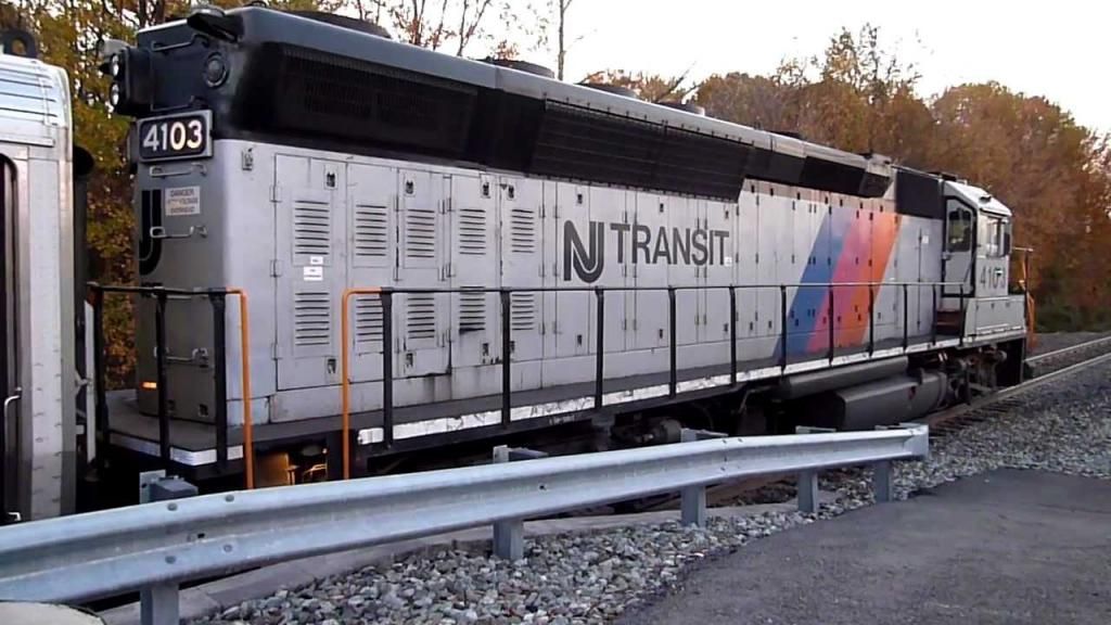

Hello. I’m going to be airbrushing a NJ Transit GP40PH-2 that I kitbashed. The model is undecorated and I’m wondering if it’s really necessary to prime the model before painting it. I was planning on doing 2 layers of the silver, masking it, and then 1 or 2 layers of the black. I’d prefer not to prime as it would just add another layer of paint that could wash out details.
Is there something negative that could happen if I don’t prime it? Would it be good enough to just put down the silver first and then the black or visa versa? I’m going to be using Model Master enamel paints. Below is a picture of the model I’ll be painting.
If a model is made of different materials having different colors, a light colored primer is generally used. However, since you are going to use silver, two coats should be enough without using a primer. Paint the light colors first and work your way to the darkest color. So the silver should be first and the black last. Red and blue before the black.

Since you are painting silver, proubly a light tan primer and then silver. Silver tends to have larger particles than non metalic colors.
On this paint scheme, you will be masking. Not saying you must, but I would definitely use primer. I could never get paint to stay on without primer when masking, it tends to pull off on me. Just something else to consider…

For the color scheme You are using and being plastic, a primer is not necessary. Throughly wash the model in a detergent like dish soap and blow dry with Your air brush. Then give it a dust coat of the silver…the whole body…let sit at least an hour and then put one or two final coats on it. Let sit at least 72 hours, before doing any masking and when You do mask it…I recommend 3M #218 fine line tape, burnish lightly with a Micro brush with brush part cut off, then You may use masking tape or blue painters tape for larger area’s. Then start painting the same way…a dust coat first, hit the masked area head-on, not at a angle…let sit, and put Your final coat on. You may remove your masking, when paint sets up, but not dry, remove at a angle, away from line. The key to masking is letting the paint cure before masking…most people are in a rush when painting and don’t give the paint time to Cure, not dry, drying is not curing.
