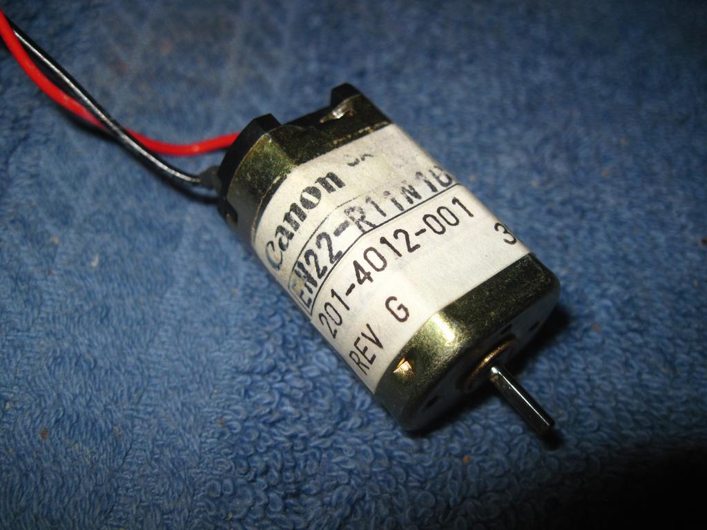

My older Rivarossi articulateds have the single shaft motor in the cab from the factory and I do my thing using a pair of can motors (Canon EN22 or Mabuchi SF-266SA) driving the driver assemblies.
Canon EN22
Mabuchi SF-266SA

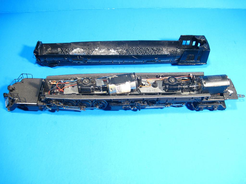

This is how my Rivarossi Allegheny looks like. It has two shaft motor, reminds a lot on Mashima 1833:
!https://up.picr.de/40018944gg.jpg
If OP’s locomotive has similar arrangement, then in fact any double shaft motor with dimensions close to 1833 could be used. The problem is, currently there is not a lot of possibilities in that range, except maybe Kato motor (excellent, easily available in the USA), or some motor(s) from NWSL (do they have some?). I did not mention PPW, because of, how to say…weird pricing, maybe?
I found replacement rotor on ebay for double shaft Rivarossi motor, maybe this could help. Just 3 GBP. Seller mentioned “full motor also available”, maybe a complete motor is also available.
Hrvoje
Hrvoje
Wow!! That is much improved from the older Rivarossi locomotives! Is the shroud around the motor metal, if so the locomotive must pretty heavy. It looks like a double shaft Canon EN22 would slip right in.

I didn’t see any mention of motor RPM for the Allegheny, the Cab Forwards are 5000 RPM so the Mabuchi SF-266SA and Canon EN22 at 6500 work out very good. Both the 266 and EN22 have at least twice the torque as the Rivarossi motor at less then half the current.

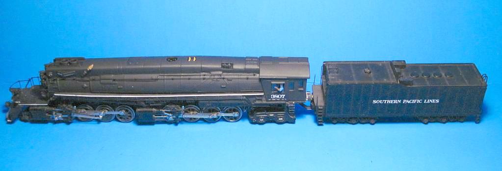

I’m currently working on an AC-9 Kitbash from a Rivarossi AC-10 that weighs 1 pound 5.4 ounces and it has 6.8 ounces of drawbar.
This is my fourth AC-9 Kitbash, it has a pair of Canon EN22 motors on a adapted Cab Forward frame/weight, I’m in the process of removing the cut up Rivarossi frame/weight and installing a Mel brass frame with a pair of new Canon EN22 motors.
The Southern Pacific articulateds are my thing, I rode in both an AC-9 and a AC11 as a teen and I never forgot them.

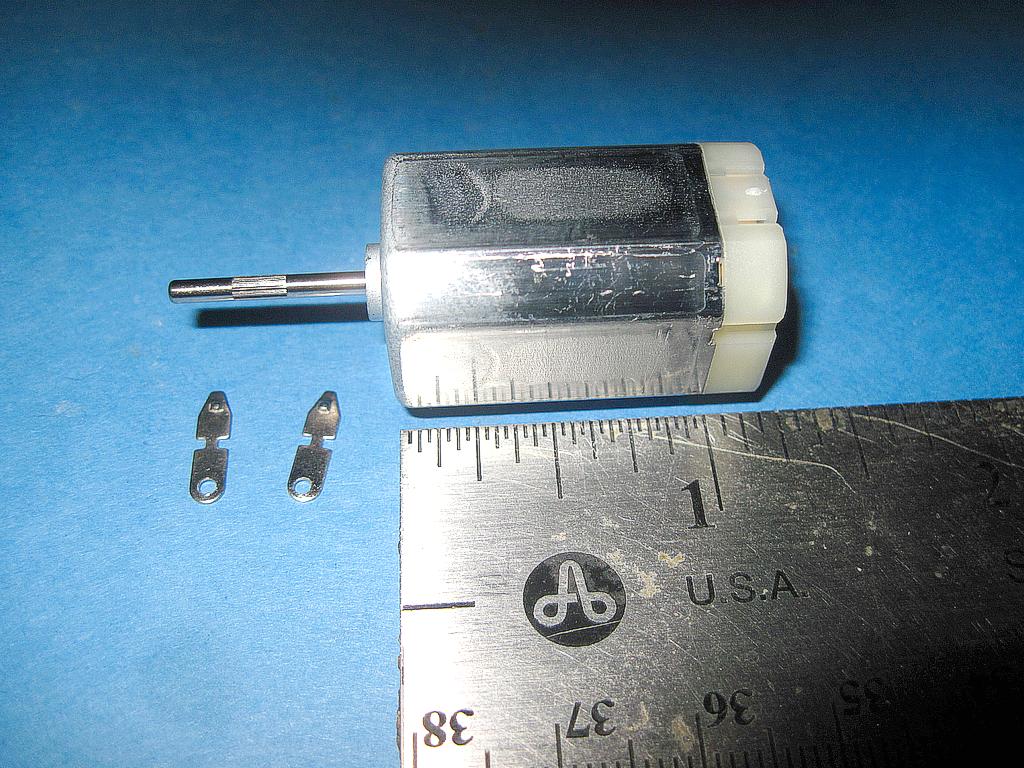

I found the motor I needed at Micromark #86529. The shafts have to be shortened but otherwise they look like a perfect fit. We’ll see…
Keep us posted, the stall current and torque are pretty low on the Micromark #86529. Half that of a Canon EN22 or Mabuchi FS266SA.
