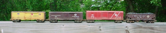

Here is my first attempt. Dusty, dirty water based paints and a cheap airbrush. I think the thing is do a number of very light coats. I use a rusty color, a dirty brown and tan and a grimy black. Pretty easy really.
Well…“d van” those cars look great, and a first attempt. WOW! Hope I can get mine to look that good. What types of methods did you use? Only an airbrush?
