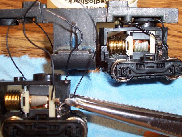

I need tips only on the isolation of the motor.
This little loco is at the end of my list of conversions. Although I have done many other split frame converstions, this is a little unusual for me.
I haven’t pulled it apart completely yet, but thought I should ask a question while sitting here having a coffee this Sunday morning.
I am going to hardwire a Digitraz DZ123 here, not needing a sound installation. But I need a tip on isolating this motor setup. Perhaps I need a nylon spacer between the motor/truck frame and the loco frame and then try using a nylon screw to hold the motor frame to the main frame?
Right now I can’t even see where the other motor contact is???
Anyone have experience isolating these, or have a link to an example on the net?

Yeah, now that I put down my coffee and unscrewed everything, I can see what to do. I assumed one the piece shown by my arrows was a contact and, of course, it was not.

I have installed a DZ123 in a 44 ton witch uses the same twin motors. You should wire the motors up in series to avoid frying the decoder. I have learned these motors can burn up. If you are not sure how to do this you need to determin positive & negative for forward direction of each motor. Then connect positive of front motor to negative of rear motor. Then connect orange wire from decoder to pos. terminal on rear motor and gray wire to negative terminal on front motor. I learned this the hard way the first decoder I wired in paralell fried. then I was advised to wire the second one in series and the switcher runs runs sweet. It also cuts speed by half so they run pretty slow. GOOD LUCK, Truck.
Does this help?
Truck is right on the money with wiring the motors in series. This little 44 tonner is one of my best running engines now. Have fun!
