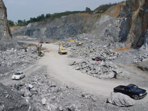

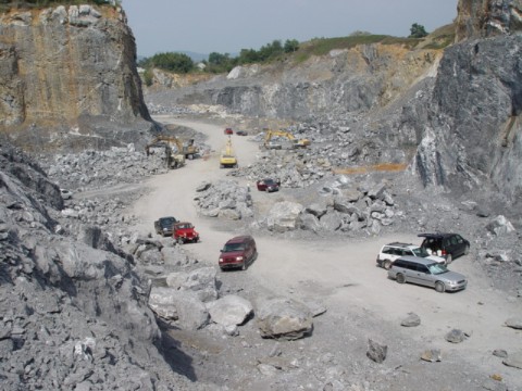

I’m doing a limestone quarry. Here are some reference sites for ideas/images, and a couple of photos of a limestone mine outside of Lexington, VA:

And lastly, some pics taken at the limestone quarry, in case they’re of interest/use…
shawnee those last pics are what I am looking for. How do you guys make up the littler stones? I understand the walls and what not but the details are the harder part.
