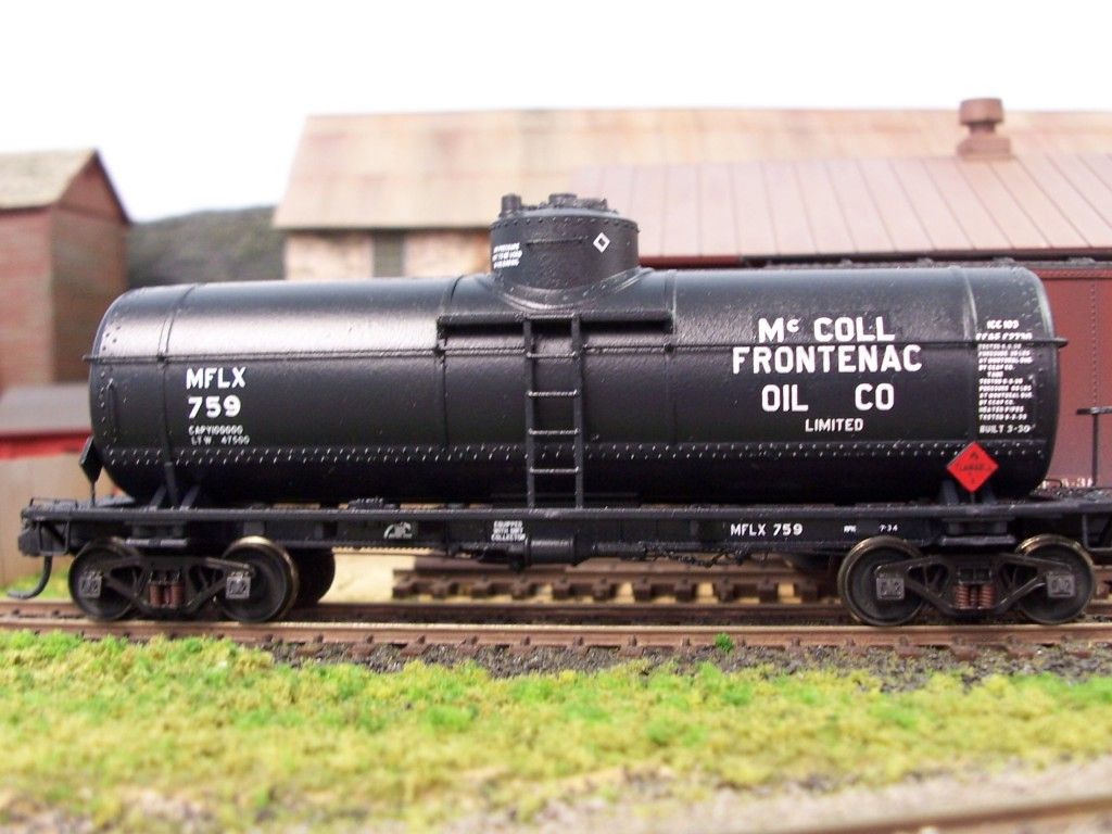

I was searching on-line for some of those cars, and one of the links took me here. I found this one at a train show last month, for four bucks. It was in the box, but missing the trucks, ladders, placard boards, and one section of handrail, plus three of the sill steps.
After removing the factory paint, I replaced all the grabs and steps with metal parts, and added brake detail. The decals are from Black Cat, although the car still needs to be Dullcoted and then weathered.
I’m not sure who made the ladders, as they came from one of my parts drawers. They look to be cut-down ladders from a Red Caboose X-29 boxcar, but Tichy offers some Canadian-style ladders (with integral sill steps) that have almost the same rung spacing. Their part number is #3076.
There used to be a product called brass ladder stock. It was found in wood car kits and was used for the corner ladders. Looking at the model, it seems to me that one could cut sections off the length of the ladder stock to make the short sections required.
