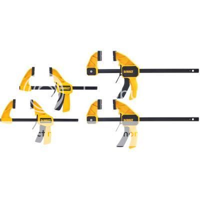

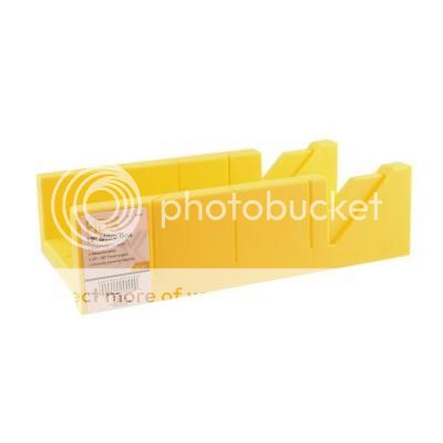

There are 2 items I use nearly every day: A full size $5 plastic mitre box from Home Depot, and a half dozen DeWalt trigger clamps:
While the box has perfect 90 degree corners inside, the whole interior is on a slight angle making it easier to work with. That creates about a 3/4 " ledge on the underside which is just as useful as the inside for use as a ‘stop’ or fense. Use the clamps to hold small stuff in place for cutting your small tubing. I think those clamps can exert 50 lbs pressure or more, vastly more than you need. I cut with a full-size hack saw with a 32 TPI blade. Never a problem.
I use the box to clamp 2 sides of a structure together for glueing, clamping one wall to the bottom and the other to the vertical side of the box. Perfect corners and nothing moves. Then you can pick the whole thing up without disturbing the bond, put it aside while the glue sets, and work on something else. Tip: line the inside corner of the box with a strip of foil if you’re using a weld type solvent so you don’t glue your structure to the mitre box.
Indispensable tools, for me.
