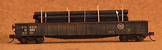

Sorry, I couldn’t get pix to display. And neither the “reply” nor “quick reply” give me an icon that allows posting a picture. Sometimes they do. This time they don’t.
Here is just the URL for the picture, maybe it will still allow you to at least click it…
http://www.trainboard.com/railimages/data/511/StLBMgon.JPG
This is N scale. not HO. I used coffee stir sticks, and mylar striping tape for the banding.
