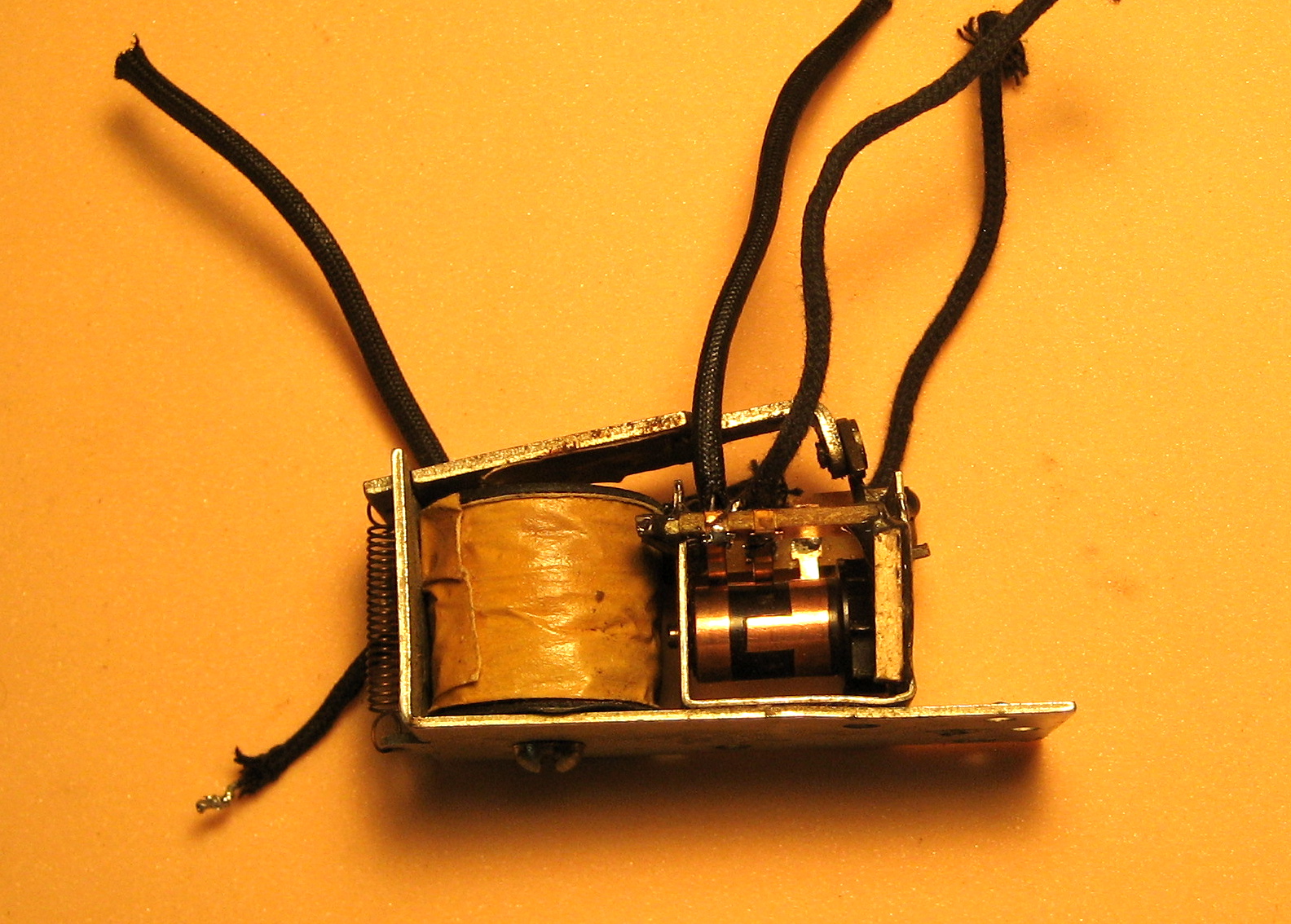

Thanks for the link and the pictures. Seems the reverse unit is an early one built sideways, but it should be wired the same as the later units. Please tell me you cycled the reverse unit between pictures 17 and 18, because the contacts do not line up on the drum as they should.
Referring to your image 0012, I will attempt to make a wiring diagram for the wires as photographed:
1____Field___
2____Power and one brush
Brush_ 3
Power 4
__ Field___ 5

  • I replaced the two sets of fingers on the reverse unit with new ones and reattached the wires as I thought they should be. This maybe where my problem, without an accurate wiring diagram?
  • I went ahead and added three new pictures of the reverse unit from 1946- 48, part number XA8731, that came off the 385 electromagnetic crane. There was some interest as how this should be wired (different then I did) because it did not work for me when I bench tested it. The fingers could be wrong also.
