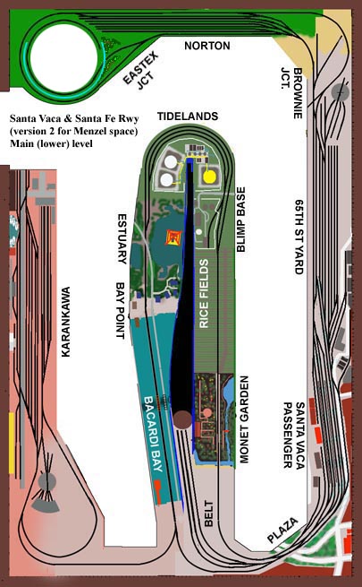

One idea I have thought about is a large unified layout with several parts that be operated as separate roundy-round loops for easy show running, or to let grandkids run something. One line would run the entire length of the layout, but other lines would run as loops-- although they could represent switching lines, connecting railroads, interchanges etc in terms of the operation of the “big” railroad.
Here is an imagined scheme that illustrates PART of the idea. This is the lower level of a layout for a large room. The layout runs from Karankawa, the port at the left, across Bacardi Bay, through Tidelands, and finally to the big city of Santa Vaca (that is everything from Belt Jct and Plaza through the passenger station and 65th St yard to Brownie Jct, then aqround a corner to Norton which serves mainly as open but inconspicuous staging for the main line. But a branch line connects via a helix to an upper level which represents a forest-products area.
However, the city scene through Santa Vaca is all double-tracked from Belt to Brownie Jct. The “sneak” connection through Belt forms a reverse loop at that end of the layout. The track through Brownie Jct, scenicked to look like a connection to the Brownsville & Mexico RR., forms a reverse loop at the other end. The second track of the double-track mainline can be used to form a continuous oval that could allow trains to run roundy-round.
Similarly, a loop could be made at Karankawa that could look like and be run as port terminal tracks-- but also form a loop that could be run unattended. Same think on nthe forest-products upper level branch. But the layout can also be run as point-to-point.
