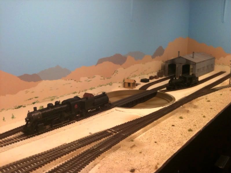

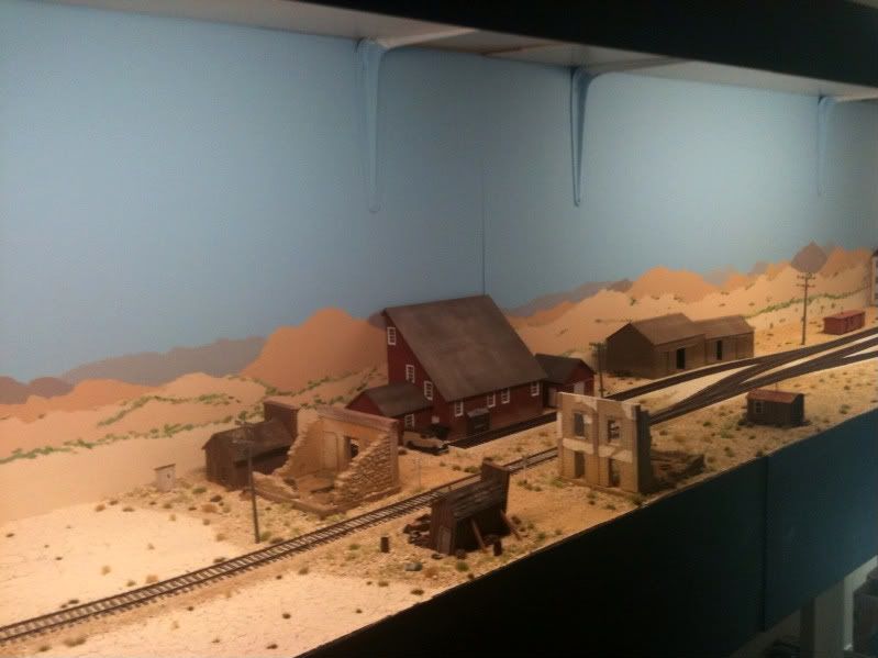

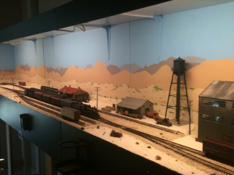

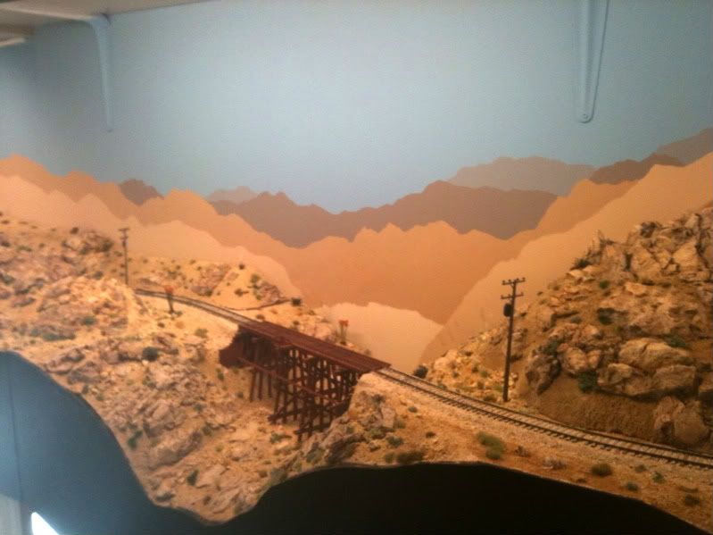

I finally took a few photos of the railroad now that some of the scenery is complete. It depicts the T&G, T&T, BG RR and LV & T between Goldfield and Rhyolite.

Very nice, NevinW. The Rhyolite ruins have the right look, and it’s hard not to love a timber trestle over a dry desert wash.

man thats sweet,is the shelf above for lighting or a nother level ? very clean and plesant to look at ,really gives the feel of the era…J.w.
Nice indeed. I like those broken down abandoned buildings.[tup]

To describe my layout: It is a 18 inch wide shelf built around a 16 X 16 foot spare bedroom. It is built to be movable in 4 foot sections. The lighting and valance is built into each section. All of the mountains are built from foam with mine tailings for ground cover. The rock castings are resin using the Bragdon method. The turntable is a Walther’s N 135’ with a new bridge built around it. Fortunately Bachmann has done a good job with their steam locomotives based on the Ma & Pa. They were built by Baldwin in the 1905-1907 era which is the same time as the Nevada mining railroads were ordering theirs from Baldwin. Even the Bachmann 2-8-0 can be used as it turns out that the Las Vegas & Tonopah had three consolidations #30-32 that are similar to Bachmann’s model with the Vanderbilt oil tender. The MDC Pullman Palace cars are dead ringers for a number of passenger cars used in this area. The only problem as anyone who have visited the ghost town of Rhyolite can testify, the mines played out early and everyone left town by 1918. The roadbed of the LV&T became the highway between Beatty and Las Vegas. I grew up in Las Vegas about 1/2 mile from the junction of the LV&T with the UP (LA,SL&SP). - Nevin
