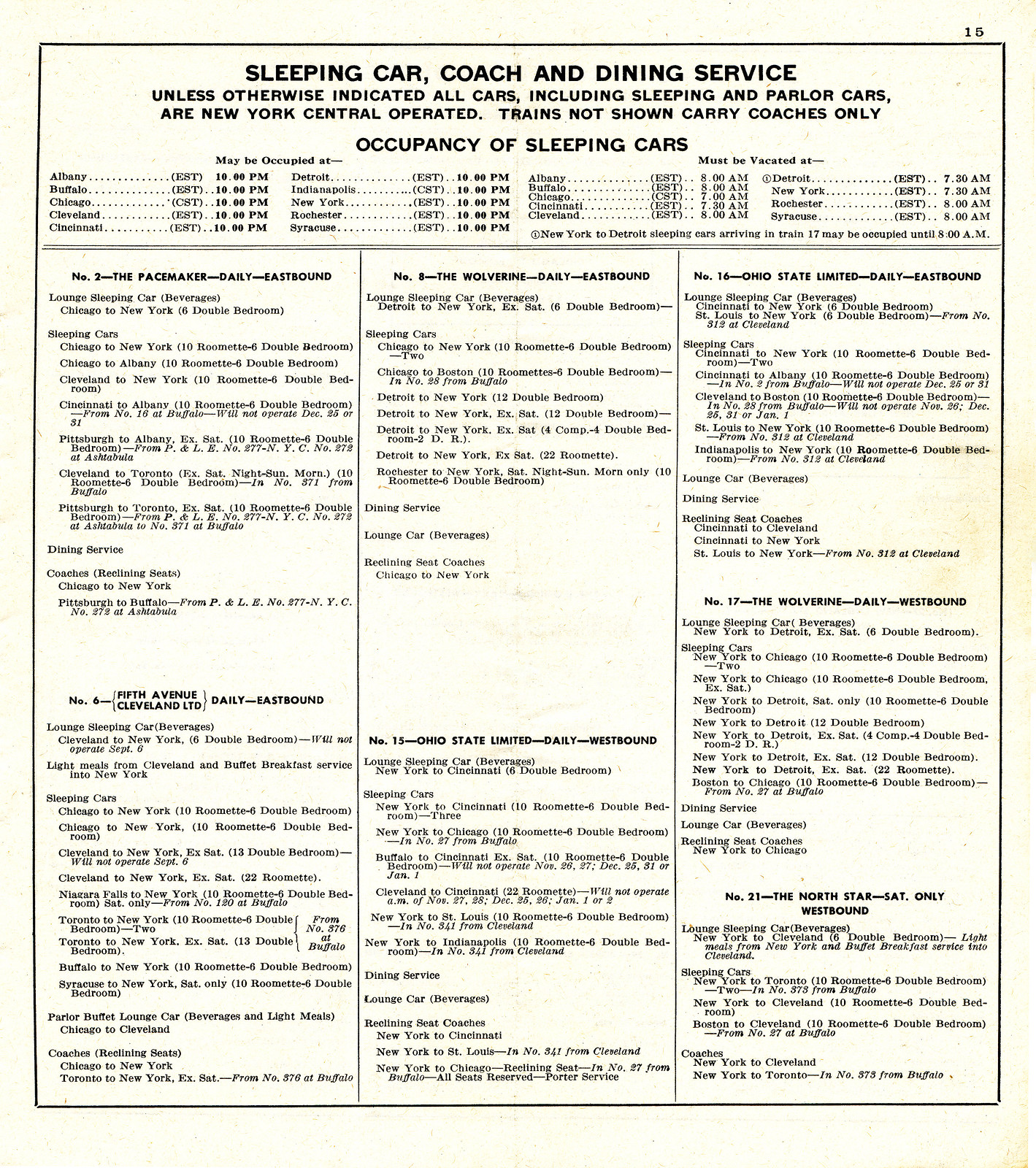

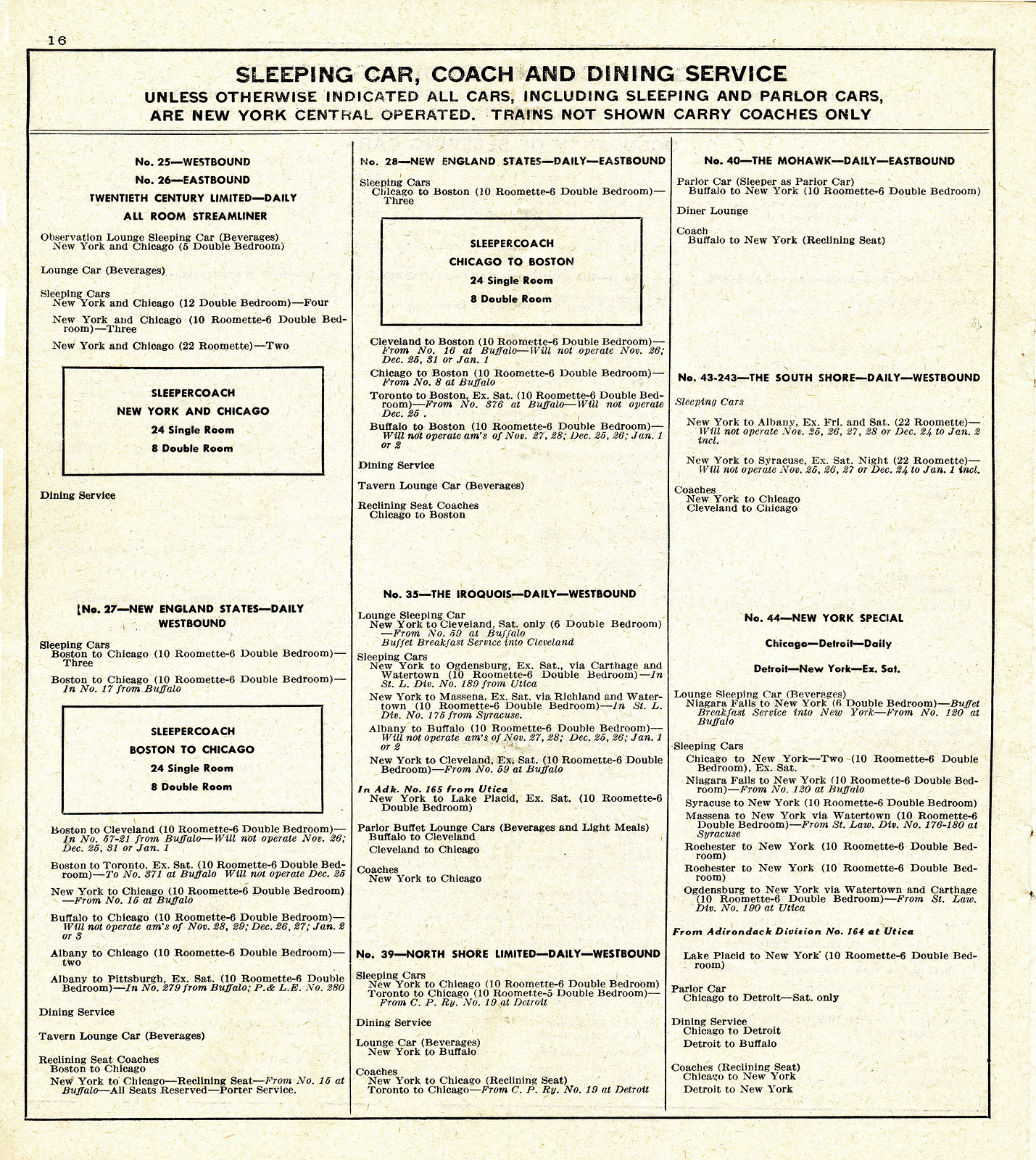

Here’s some examples of equipment assigned to various NYC trains from the October 25, 1959 Form 1001 (System Timetable):
NYC 1001 by Edmund, on Flickr
Note just how many cars are added and removed en-route, for instance Pullmans from Pittsburgh are added to #2 in Ashtabula headed for Toronto (except saturday!). I believe many modelers don’t appreciate the extent to which passenger trains are reconfigured along the route.

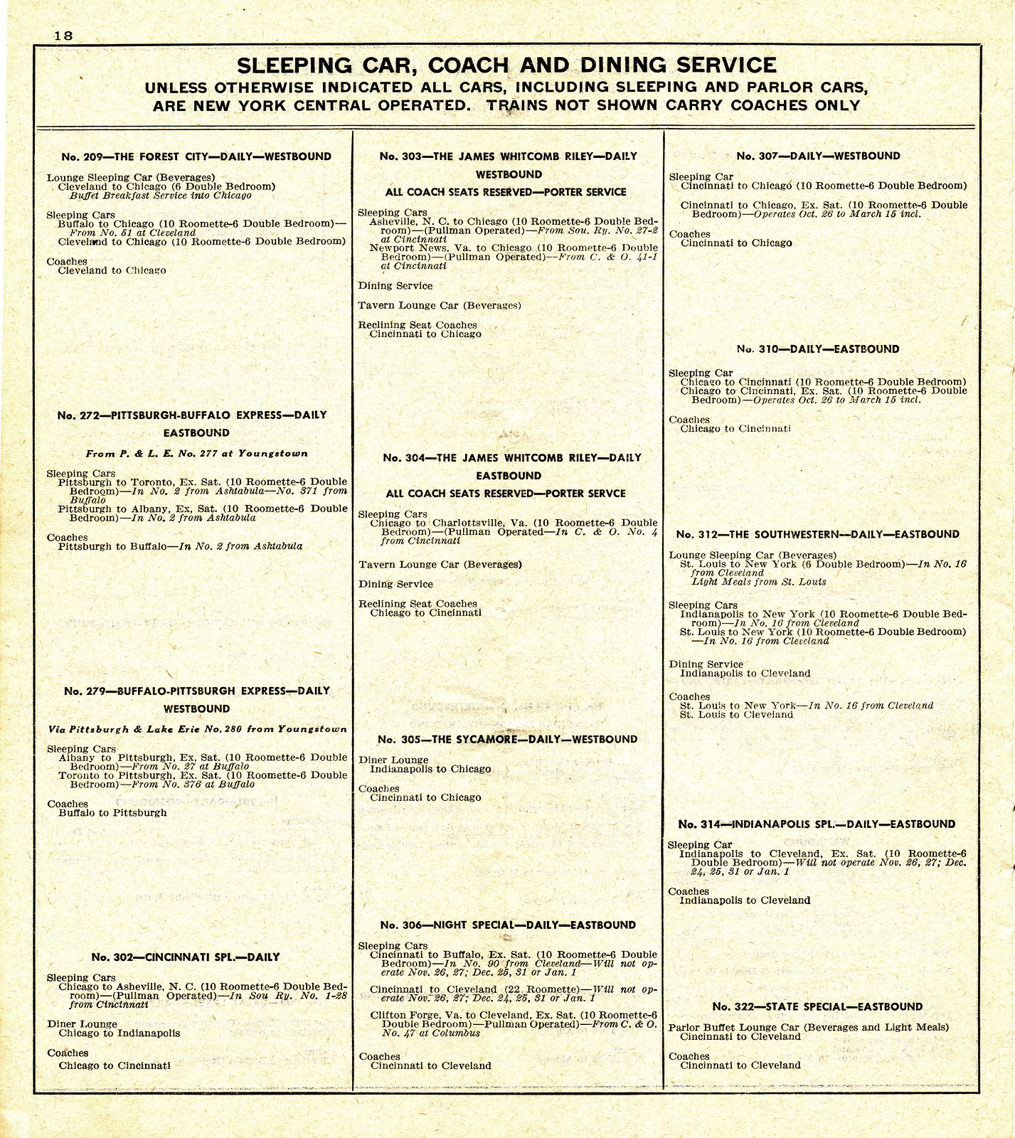

NYC 1001_0001 by Edmund, on Flickr
NYC 1001_0002 by Edmund, on Flickr

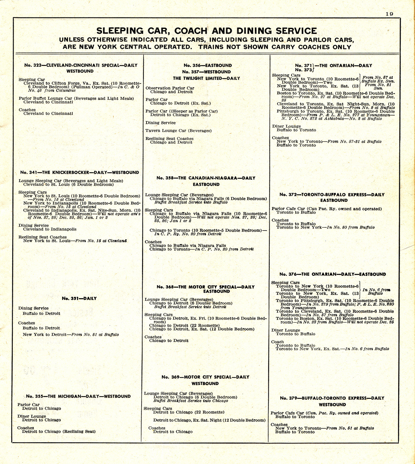

NYC 1001_0003 by Edmund, on Flickr
NYC 1001_0005 by Edmund, on Flickr

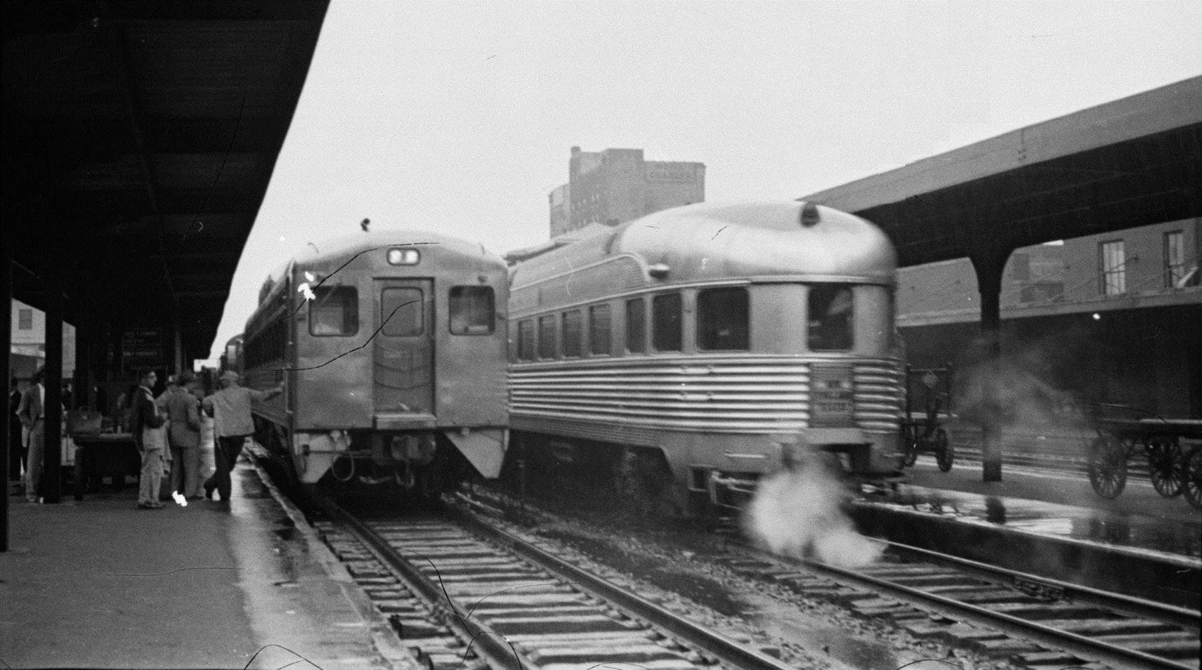

Rear of the New England States, westbound, in its all-Budd days next to the first scheduled RDC, in Worcester, Massachusetts November 1949
