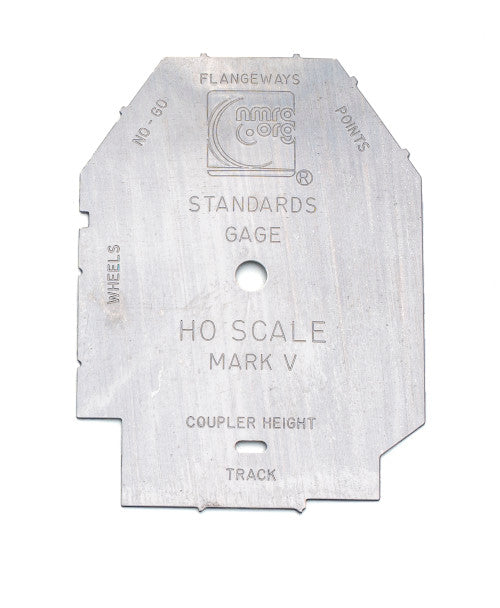

I have 2 gages. The upper left of the MARK IV is a “NO-GO” section that is not on my MARK III. What does that measure? On the MARK III top is 3 prongs that don’t appear on the MARK IV. They both say “FLANGEWAYS”. Why 3 on one and 2 on the other? Bought these both used, so no paperwork.

I didn’t watch the whole thing, but the no-go notch has to do with wheel width.
I presume that somewhere in the video he discusses the pins.

Here is a photo of a Mark II gage, likely from around 1968 when I joined the NMRA. It orginally had the center top prong, which is the same flangeway “No-Go” as the left angled side prong on a Mark IV or V gage.
I removed the center top prong years ago for the same reason the NMRA redesigned the gage.
They redesigned the gage and moved this feature because in the top location it prevents you from properly using the gage to measure crossing flangeways with the other two prongs.
In this picture you will see from left to right, Mark II, Mark IV and Mark V versions.
AND, if you look REALLY close at the top of the Mark II gage, you can see the litttle dip where I ground off the center prong.
Any other questions?
