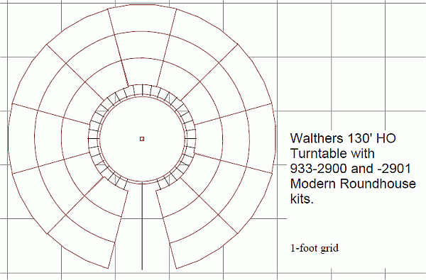

That’s very improbable…? As even the modern Walthers roundhouse with a 130’ TT only takes up 42" squared:
Maybe 4’ x 8’ ? As that would give space for coaling and cleaning facilities.
Graffen, that may be the strict physical dimensions of the round house and turntable, but you neglect two other important factors: overhang and access. For overhang purposes, round up to 48" squared. For access, add at least 2’ on at least two sides. Believe me, the space required on my layout to model a 9 stall round house and turntable requires a 6’ x 6’ space.

Well, I did add 1" all round… Without that it’s 39-40" squared with the 130’ TT. With the 90’ it’s only 37’… I have made the calculations for my own layout, and that’s where I got the measurements… I will only have 6 stalls and a 90’ TT, so I will manage with a 32" depth but almost 5’ long… I don’t get your 6’x6’ size, how can you get access?

The Original Poster wants a near full circle, which is about 5 feet on a side in HO even without the other facilities or a means of access – certainly can’t fit on a 4X8 as you suggest.
