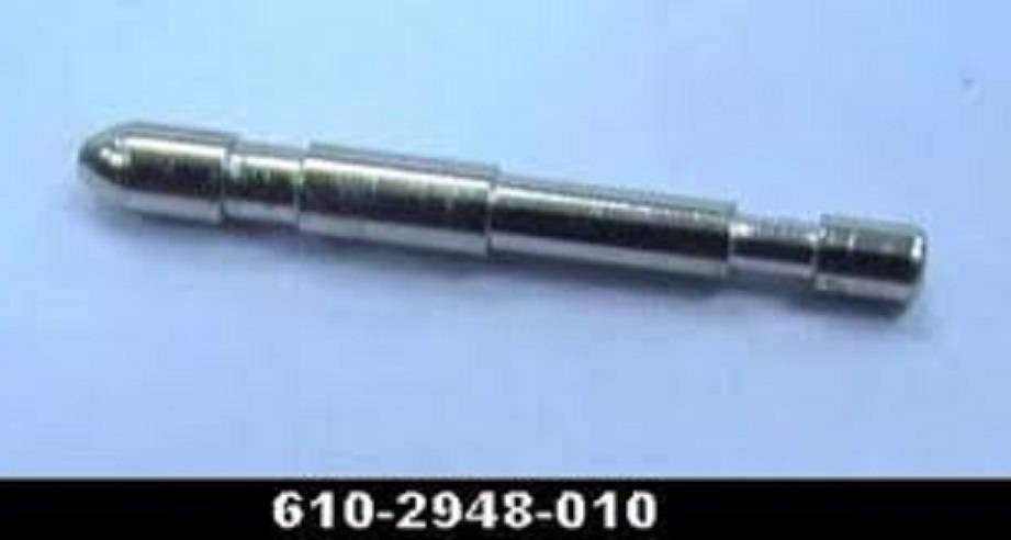

Here is the Lionel adapter pin
Larry
Although this part is offered, it will be quite a bump at the transition point due to a design flaw.
It really should be offset, like the GarGraves adapter pins.
You can make your own by starting with three “O” pins, and grind one end(to the half way point) of each 3/4 of the way around to match the diameter of the O-27 track pins/openings.
If you instead grind them to the center like the above Lionel pins, there will be a significant “bump” at the transition.
For an example of this “offset” method, look closely at the GarGraves “O” & O-27 adapter pins:
And actually, forcing the O pins into O-27 at the transitions works quite well, and the bump is reduced to the slight difference in sheet metal gauge used to form the rails.
All of this assumes that you realize you will need to shim your O-27 track ties up slightly to match the track height of “O”.

You would not try the mating pins you pictured?
Ed
If you must mate O27 to O, and I really distain using O27 track, It’s a lot simpler to just crimp the O end of the track slightly narrower and insert the male O27 pin into the O track opening. You can crimp the O opening smaller or just bend the O27 pin to the side so it fits tighter.
If you want to mate O27 to O, and I really like using O27 track due to the wide variety of pieces available, the lower cost, & better aspect/appearance, it’s actually a lot simpler to just force the O track pins into the O27 opening.
It’s a much cleaner & more mechanically sound connection method and the O-27 rails can later be re-formed easily around a O-27 pin with track pliers if desired. Using a O-27 pin in “O” rails leaves a lot of extra metal material in the webbing area to disrupt the transition even more, and it frequently tears/fatigues the metal of the tube section trying to close down around a smaller pin.
