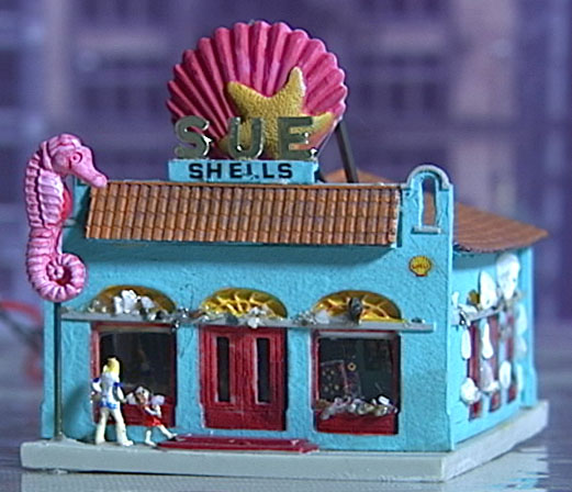

As well as more space for touristy stuff like shell shops

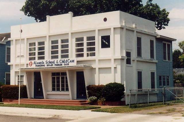

I found a few higher quality bathing suit figures from a set of 100 or so unpainted figures from a European manufacturer. There is an interesting structure six blocks from my home, now a day school, formerly a music school. I have shot pictures to model it “someday” as a dance academy.
And I have painted most of the smallish-girl figures with black leotards and set them aside for that project.
