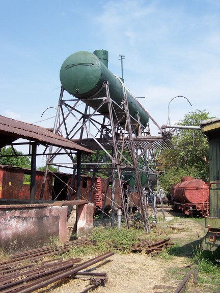

You will need a source of fuel oil. In the one facility I am familiar with (others could be different) the main storage tank was underground and slightly removed from the facilities, and the oil was pumped underground then up to an elevated day tank. This tank (see picture below) had gooseneck spouts on both sides to service two tracks, access platforms for maintenance, and may have been insulated when in service. remember that fuel oil usually requires steam heating coils inside the tanks to maintain the oil at a temperature at which it can flow. But this is a detail that isn’t really visible.
