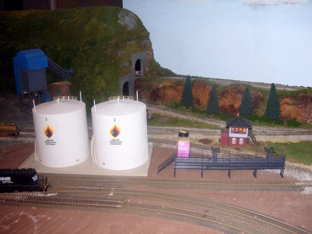

Ok, here are a few pictures of the current progress. This first two pictures show the completed storage tanks in what I am calling Location #1. The bottle of Dullcote represents a future small building.
This is location 1A (loading facility and building are on the same side of the tracks as the tanks)
The advantages of this location are that I have a long siding and the tanks don’t block any major scenery behind them. The piping would go over the tracks with location1 but not 1A
Here is Location #2.
The advantage here is it maximizes space usage and has a dedicated siding but the big disadvantage is that it blocks the view to the coal mining operations behind it. I am leaning towards location 1 or 1A.
I am also debating on concrete berms, making my own with ballast/stone material or none. If I stay with the concrete (styrene) pad, I probably should raise the berms. Right now they are scale 22" high. I could add 1 ot 2 more pieces of .25" styrene and get it to 43.5" or 65.25" . I am also considering a chainlink fence on top of the berms (only with concrete). If I go to 43.5" or 665.25" I will reduce the height of the fence considerably.
I know the red airplane lights on the tanks aren’t protypical but I like how they turned out. Once I decide on the location I will finish the oil loading platform and add the piping to the tanks.
Feedback is welcome and for Tom Stage, all pictures are less than 60kb in size.
