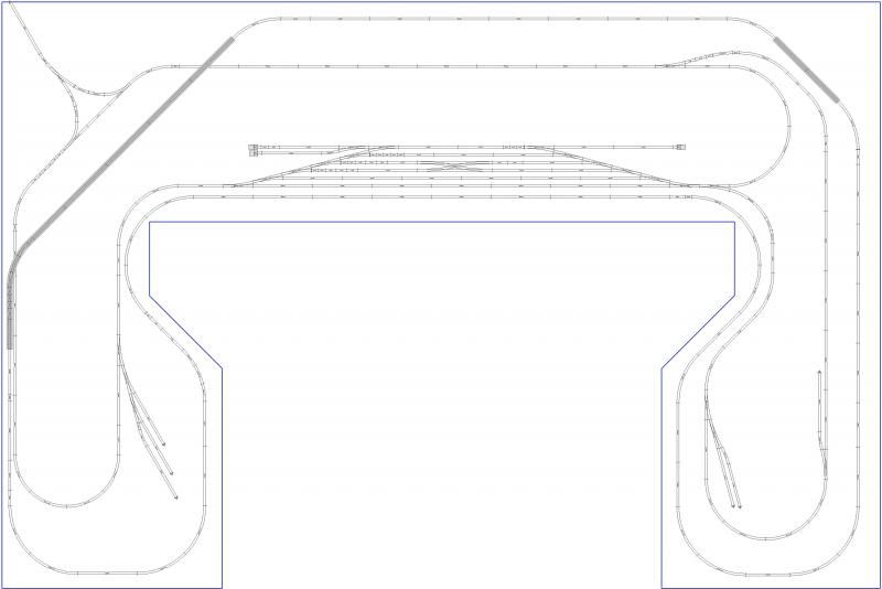

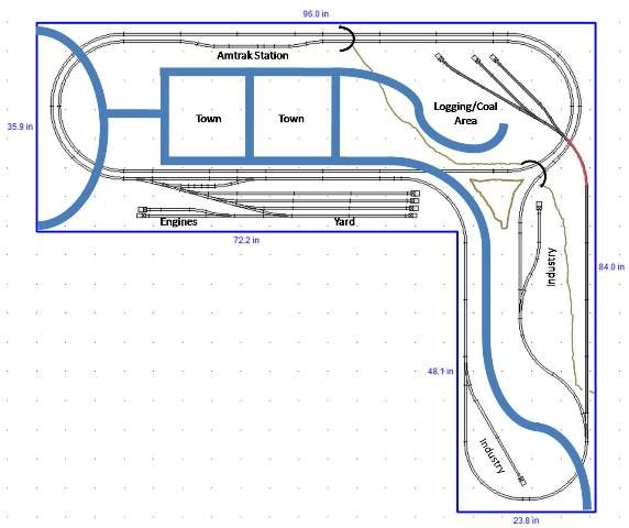

Well to answer some questions, I was looking at N Scale as it allows for more milage in a smaller space. I have been looking through all the plans that are here and around the web and have taken a few ideas that I like. I have been using the SCARM program to plan a layout that could accomidate what I am looking for. If I could figure out how to post a picture here, then you could see what I’m going for. Now that I work for BNSF, I see alot of potential everyday to put in my layout. As an old model builder and wargammer, detail is a big thing to me so I know that I’m in for a long build…
Ok now that I figured this out here are two layouts that I have messed around with… Comments and advice is welcome.

http://i145.photobucket.com/albums/r202/Unknown_Soldier_photos/Train%20Stuff/1stlayout.jpg
http://i145.photobucket.com/albums/r202/Unknown_Soldier_photos/Train%20Stuff/biglayout.jpg
One of us needs to do some more figuring this out. I was unable to view your track plan.
I like the first one. Very traditional. The yard coud use some work. Run around or AD track just seems too short, no drill track, and the switchback to the loco service area wastes a lot of yard capacity.
The second one is more interesting. I don’t understand the wye track in the upper left, nor the purpose of the double crossover in the middle of the main yard.
I think eventually you will want the two tracks to connect so a crossover or two might be in order.

well, i was liking the bigger layout as well. the wye was for possible expansion as well as turning engines around. As for the cross over in the yard, i put it there on a whim…not really sure if it will stay. Still in the planning stage for the benchwork and such but its coming along…thanks for all the advice and ideas.
