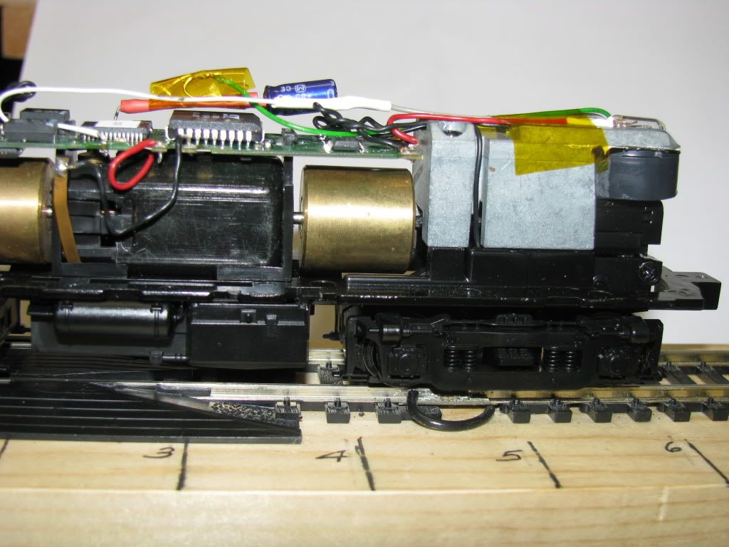

I put a Soundtraxx decoder in my Canadian National RS-3 with a bit of work. Here is a photo of the modified weight with the speaker mounted over the truck. Sound is a little weak but OK.

Farrellaa, went thru your work photos and man, that’s nice work, even in HO. I’m having trouble doing stuff like this in O scale. Guess it’s an age thing. Bill p/s Don’t worry about the sound quality. As long as it work’s, 'nuf said.
