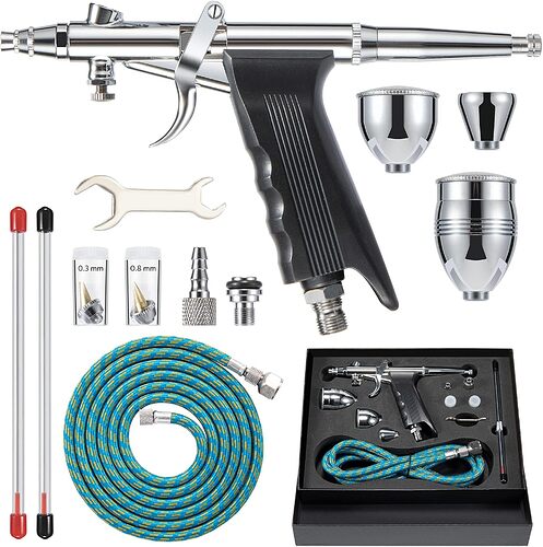

I also splurged a bit and bought this, too:

That’s a pretty solid set up you got there. As for paint a lot of people like Vallejo Air and Tru-Color for air brushing. I recently got an airbrush from Harbor Freight myself and am looking to try it sometime too.

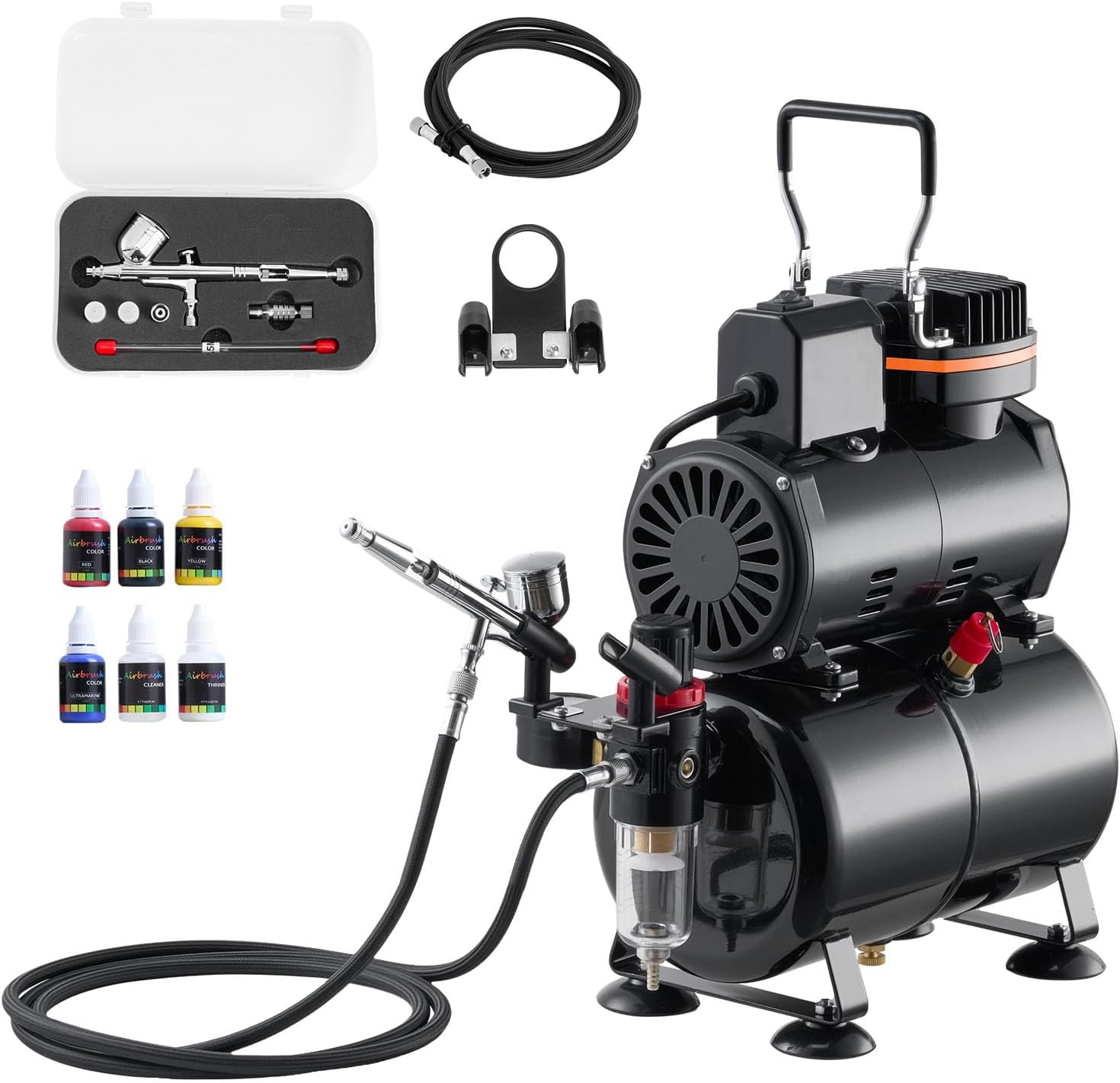

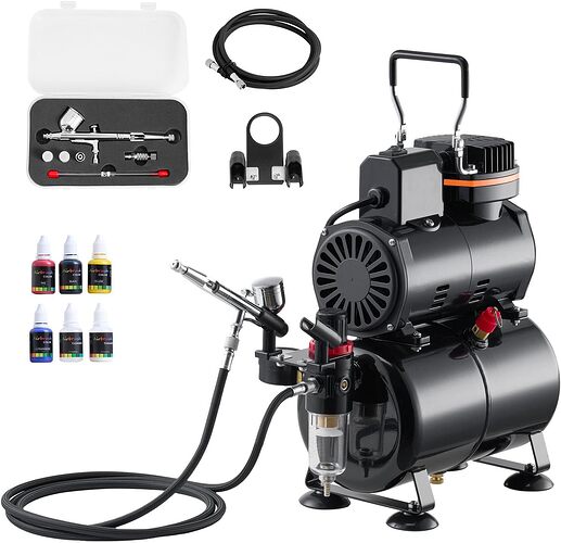

It’s hard to tell from the photo and the limited specs. It has a moisture trap, but it does not appear to have a pressure regulator. You can buy one though. The comments complain about a lack of fittings on the compressor, so you would need to buy the fittings as well.
Yes, it has a pressure regulator. I went to the VEVOR site to see the exact same kit. If you look behind and below the airbrush, you can see the pressure gauge. It’s behind the airbrush holder and lying flat and facing up on the rear of the pump, which is why it is hard to see.

I don’t think that’s a pressure regulator; it’s just the tank pressure gauge. The only ‘regulation’ of tank pressure is the deadband they mention (between 43 and 57psi) which controls compressor operation.
On my compressors, there are two pressure gauges, just as on acetylene-torch regulators: one gauge shows tank or reservoir pressure, the other shows regulated pressure going to the tool. I think that you do have pressure control present on the top of the water separator – that little screw T-handle probably goes to a disphragm under the dome – but you’re only going to be able to set it to pressure with an external gauge or manometer on the airbrush hose, which I’d bet you don’t yet have.

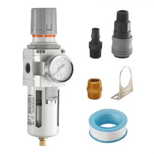

I’d advise installing that $29.95 regulator or something like it if you want the ability to set pressure quickly and effectively at any time.
Can you provide a link to the correct pressure regulator, as I understand there are several different hose connector sizes.
The more precise regulator would replace the one that comes with the compressor – you’ll turn the gray knob the same way you’d adjust the T-handle. Whatever nipple thread comes out of the tank gauge is the size to use – either ½" or ⅜" are the common sizes and all this is ahead of the fittings that reduce ‘tank’ or ‘regulator output port’ size down to airbrush-hose supply size.
The bad news is that the VEVOR regulator in ½ inch input size shows as ‘Out of Stock’ and in ⅜" size as ‘Discontinue’. It might be time to consult Harbor Freight or eBay… :zany_face:
I found a site in Europe that had the VEVO regulator in stock, but I had to search a lot of places before I found it. It was sold out on Amazon, Ebay, and all the usual suspects.

It looks like it may have a combo regulator/water trap attached to the compressor..
I think you’ll be set. I’d at least wait until it arrives before buying any additional parts you may not need.
It does. That little T-handle on top sets the output pressure.
What he does not have is a gauge that shows him the regulator pressure. That would be easy enough to make with a conversion fitting and something like a car (not bicycle) tire-pressure gauge, but it might be tedious to measure the number of turns from closed to each target pressure he might want to spray with.
I think the regulators Rich found for him are intended for use on much larger compressors.
