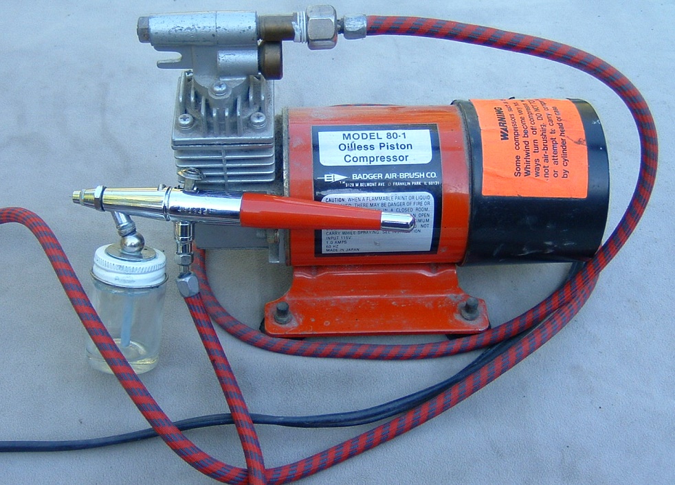

Over 20 years ago I bought a couple of Badger airbrushes of the type that SciFi illustrator legend Jim Burns used. HE has not (or maybe just rarely) used air brushes in over 20 years himself, because he knows how messy they are, as he stated in interviews and at a chat at Norwescon many years ago. As an artist, he is hooked on digital, without any chemicals or paint or paper.
Anyway, so I used my airbrush kit on the kitchen/dinner table in my apartment for some fantasy-art. By the time the 50x80cm or so (20x30in) was done, the white cabinets in the kitchen were greenish brown, because the vapours had settled everywhere!
NOPE, did not do any airbrushing after that!
