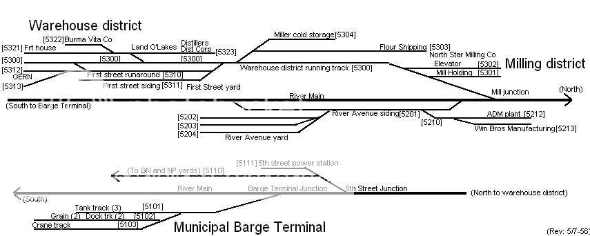

What you are asking is not “operations” vs “rail-fanning”. It is “point-to-point” vs “continuous run”.
Continuous run, if you want it, can be achieved in a number of ways, even on layouts that are intended for point-to-point operations.
One fairly common way on layouts that nominally are point to point operations is having a shared double ended staging that functions as staging for both ends of the layout.
Here is a schematic of my layout:
Looks pretty point-to-point with three staging destinations (the arrows at the end of tracks), doesn’t it ?
This is how it actually is implemented:
So by running through staging, I have continuous run. Some variant of that is fairly common in many layouts that nominally are point to point.
