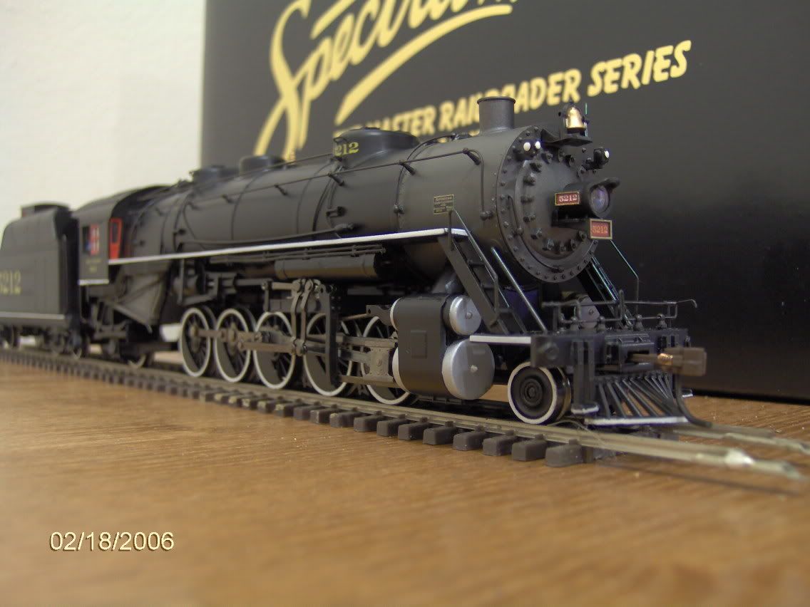

Here’s a couple of shots of mine. I can’t comment on the performance… my
layout is being dismantled, so I have only tested it with a little back and
forth running. Dave
(Click)
