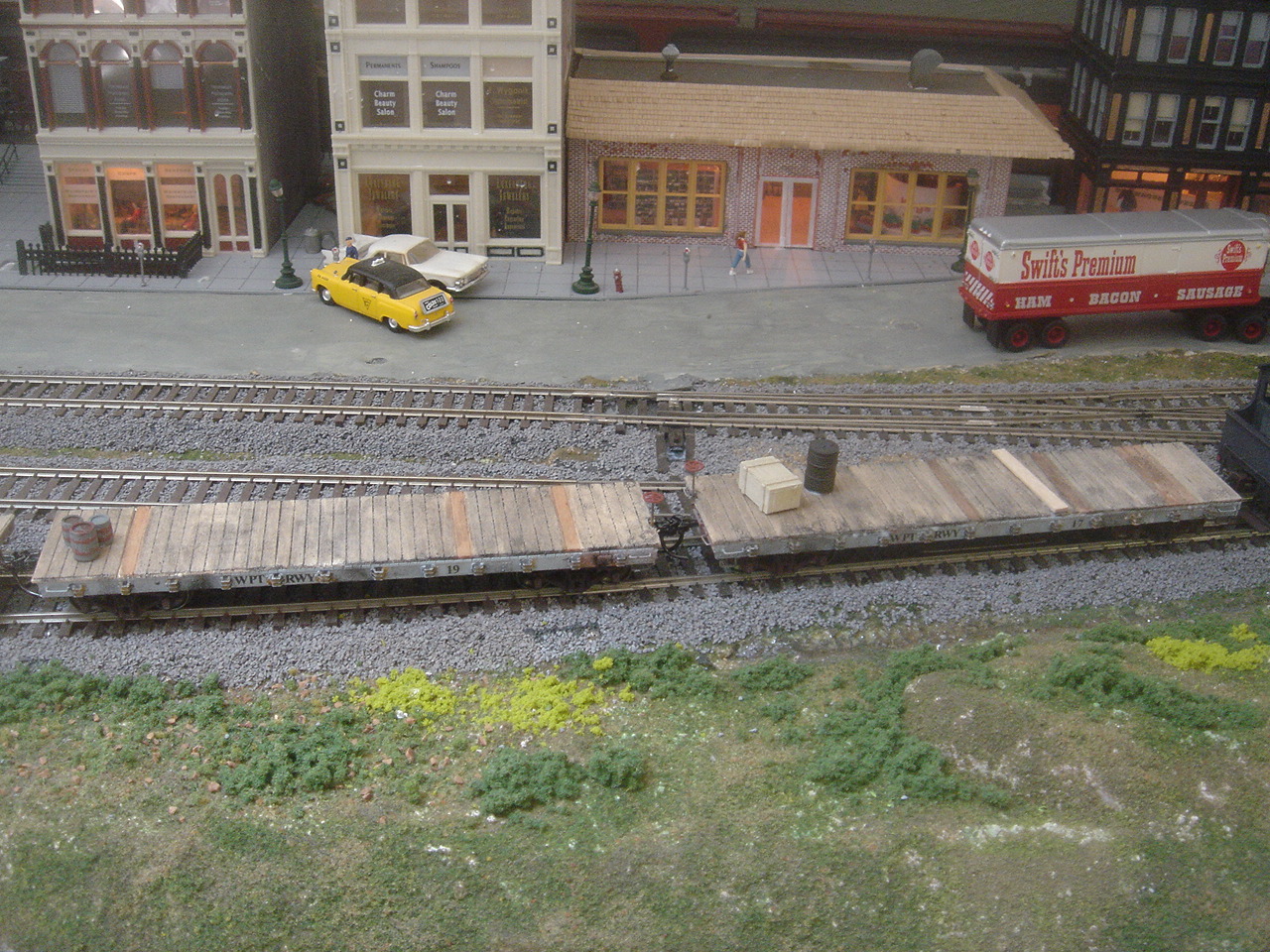

I built 3 of these flat cars to use as “idler flats” for my carfloat terminal:
These particular kits are nicely detailed. The stake pockets on the sides are individually applied pieces. (One could say that’s “sadistic,” and I would not disagree.) The underside is nicely done with full brake gear and piping. I added a real wood deck.
The trucks on these are, well, just plastic trucks. I replaced the wheels with metal Intermountain ones. They work just fine, and look good with some painting and weathering.
