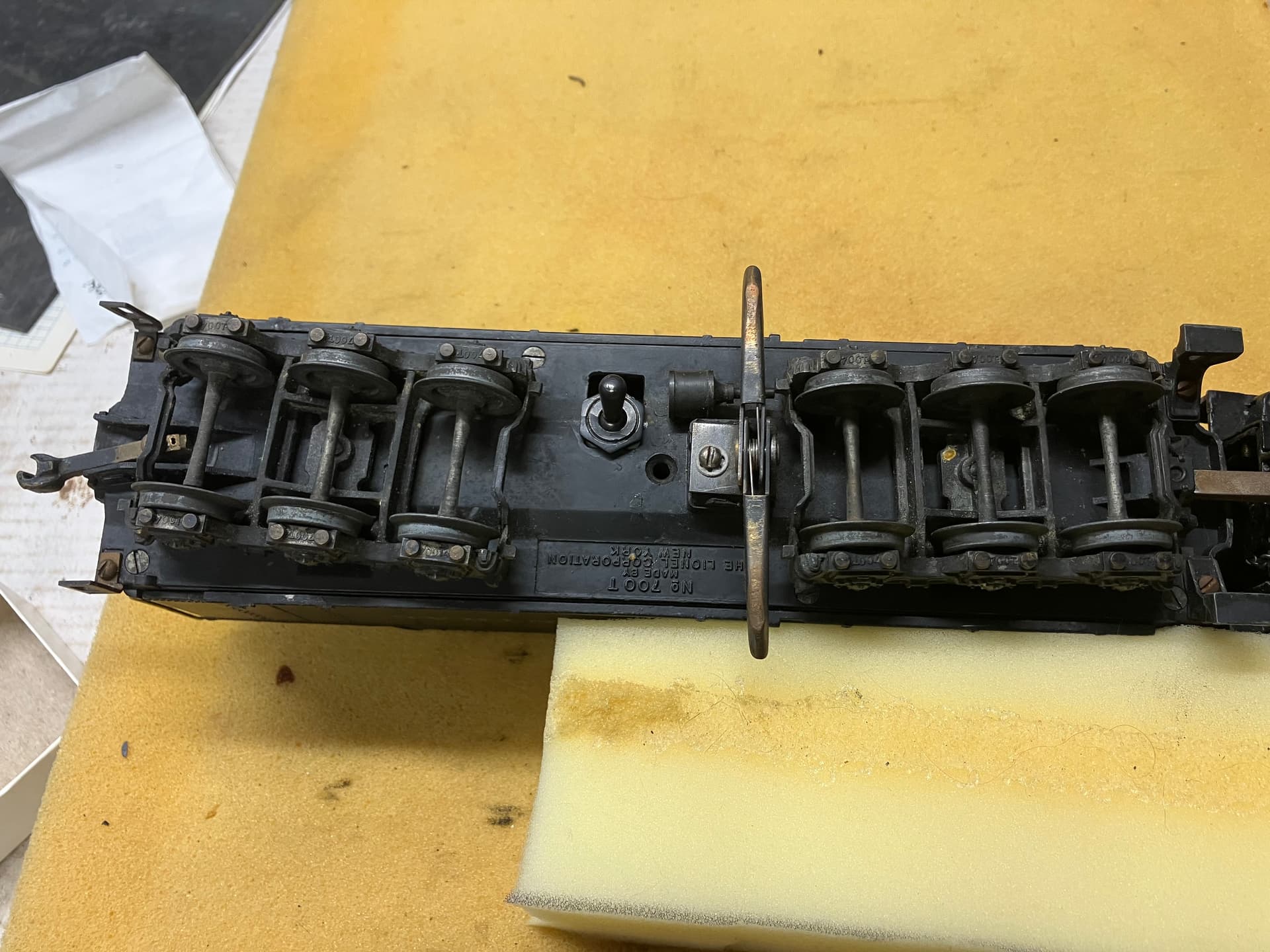

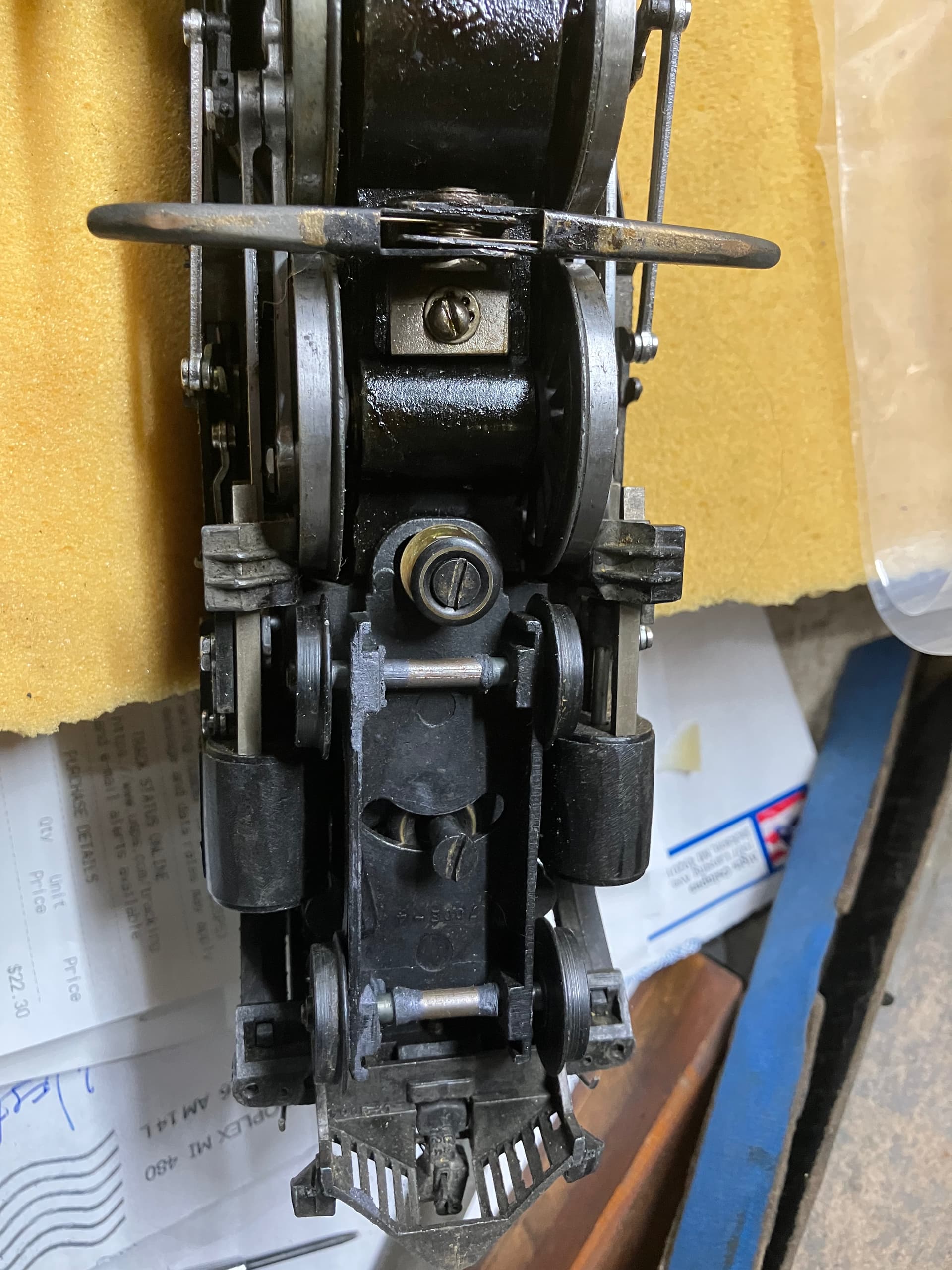

I have a 700E with outside third rail pickups. My Dad used to run it at the Stamford CT club back when it was outside third rail. There is one pickup installed between the first and second drivers and one between the trucks on the tender.
Were the outside third rail pickups an option offered and delivered installed by Lionel, or a special conversion kit offered by Lionel, or was it produced by
an aftermarket supplier?

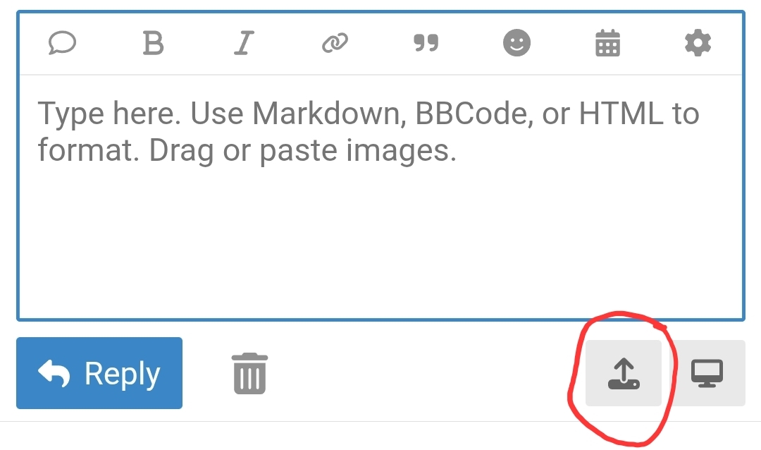

I’d post a photo of the pick ups, but I haven’t figured out how to do that here
